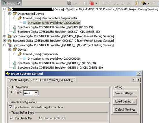

Having done this, I can launch the debugger, and the three cores connect as usual. At the bottom of the list of cores is a new entry for the ETB_11:
- Spectrum Digital XDS510USB Emulator_0/ETB11_0 [Non-Project Debug Session]
  - Disconnected Device
    - Thread [main] 9Disconnected(unknown))
      0 Symbol not available
    Spectrum Digital XDS510USB Emulator_0/ETB11_0 (11:30:27)
    Spectrum Digital XDS510USB Emulator_0/ETB11_0:CIO (11:30:27)
If I disconnect core_0, and then connect to target on the the ETB entry, I can access the Tools->TraceControl menu.
But, I can't then load code into the ETB entry, or re-connect to core_0.
(If I don't disconnect core_0, I get lots of errors when I connect the ETB_11.)

    Task manager. I do have a TraceServer.exe process in the Task Manager. It is created when I launch the Target->Debug Active Project menu.
    (It is present even when I do not have an ETB_11 node in my ccxml file.)
    If I do not have an ETB11 node in my ccxml file, I get an error when I click on Tools->Trace Control.
    If I add one as below:
    I can reach the System Trace Control dialog box, BUT only if I disconnect core zero and connect ETB11 instead:
    Having disconnect core zero, I can't load a program and run it.
    I think I am quite close to making this work.
    I suspect I am not setting up the ccxml file correctly.
