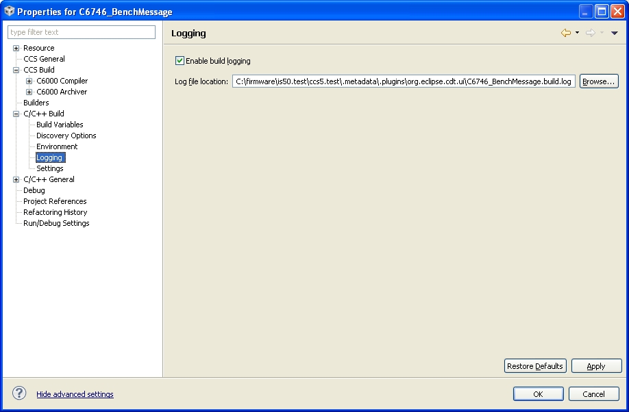

3) The build logging setting does not seem to be kept with the project files; instead it is in the CCS5 workspace metadata.  How can I set this in my projects so that it is stored with the project and is portable between different developers?

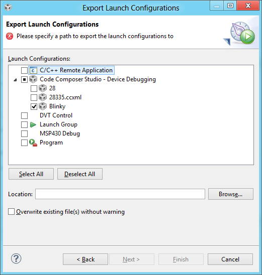

    Do you mean the option to output console output to file?  (i.e. right click on your session in the debug view and go to common and select to log to file)  If so that option is stored in something called the launch (or debug) configuration.  You can export your launch and import it on another machine.  From the file menu select export.  Select Launch configuration.  You will get a dialog asking what to export.  Here is what I select to export the launch configuration from my project called blinky.

  • 3) No, I mean the build output:

  • 3) You can change the path where the log file is going.  By default it places it within the metadata of your workspace but you can change that.  I have tried putting in a variable there but haven't had any luck.  Also tried just a filename but the log doesn't seem to get created then.  Thus to make it somewhat portable you would have to specify a pretty generic location like C:\logs\project.log
