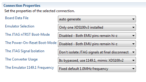

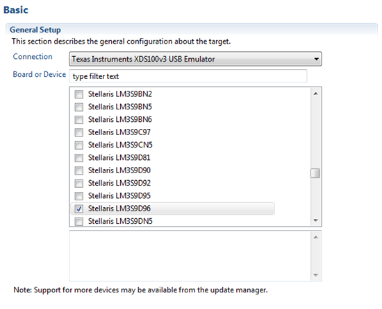

Settings are:
Texas Instruments XDS100v3 USB Emulator
Stellaris LM3S9D96
Advanced Settings are default, as recommended by another thread.

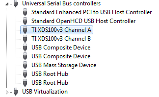

The adapter appears in Device Manager correctly:

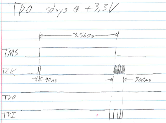

  • Double check the results you were getting on the TMS pin.  It should not remain high during the testing.  If so there may be a broken connection or it might be short/tied high.
    Ok, I had done some more detailed oscilloscope traces and that seems true now.  The TMS goes high on an initial TCK blip, then after a few seconds TMS goes low and TCK starts clocking and TDI sends input.  Here's a rough drawing of what I'm seeing:
    Does that help any?

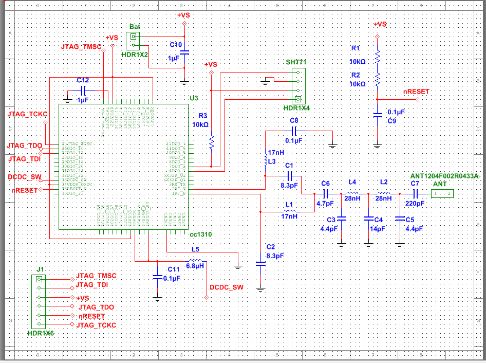

  • For further clarification, the schematic layout of our compact TI 20 pin JTAG port is shown in the first post of this thread:
    20-pin Compact TI JTAG Port Pinout and Layout
    I'll try to post a graphic later too.

  • The following is the error message that I am getting.  We are using the xds100V3 to debug our cc1310 MCU.
    Error connecting to the target:
    (Error -233 @ 0x0)
    The JTAG IR and DR scan-paths cannot circulate bits, they may be broken.
    An attempt to scan the JTAG scan-path has failed.
    The target's JTAG scan-path appears to be broken
    with a stuck-at-ones or stuck-at-zero fault.
    (Emulation package 6.0.83.1)
    Could you help me figure what's going on with our debugging process?
