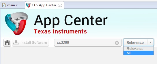

  • I just bought a TI CC3200 launchpad demo board.  I am running windows 7 and I have just downloaded and installed code composer studio 6.0.1.00040 as per the instructions in http://www.ti.com/lit/ug/swru376a/swru376a.pdf.
    When I attempt to install the required add-ons, the TI-RTOS for simplelink add-on appears, but I cannot find the CC3200 add-on.  I tried to continue without installing this, and none of the example eclipse projects will build.  When I got stuck, I uninstalled and reinstalled code composer studio and it still did not appear and your example projects still would not build.

  • Hi Alexander,
         See, if this will work. At CCSV6 App Center type "cc3200" at the search box and change "Relevance" to "All". See, below. CC3200 Add-on and TI-RTOS for Simplelink should appear.
    - kel
  • If you have installed 6.0.1 then you may already have CC3200 support installed.  For 6.0.0 you had to install an update to get it but that package was then included in 6.0.1.  If you updated from 6.0.0 to 6.0.1 the you would need to add it like Markel has shown.
