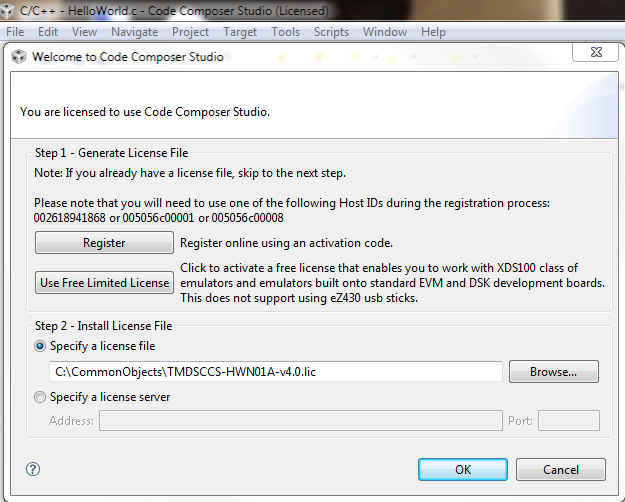

  • Hi!
    Notice the following screen:
    I have already performed this step several times before. When I repeat it, the caption again reads (Licensed), without the number of days still to go. I don't know what triggers the CCS to again start counting days. The .lic file is what was sent by the email. During the process required to obtain the license, I have to specify MAC address for my PC. I have done that. How can we check if the license was properly accepted or not?
    Is there maybe also some form of registration of XDS110 or XDS510 on the EVM required so that the license generated will cover both?
    Thanks!
    Atmapuri
  • Hi!
    I got a reply from Spectrum Digital. The solution is to select "Spectrum Digital DSK-EVM Plus onbard USB Emulator" as the "Connection" in CCS v4. not the "Spectrum Digital XDS510USB Emulator" which is meant for the standalone emulator.
