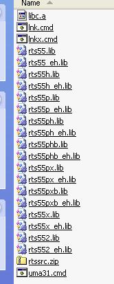

    Anyway that message is when memory models do not match. You can try using a different lib. The "rts55h.lib" is the lib for the huge memory model and looks like your project is "large" so just try the other library in the same directory (the one without the "h" - I guess "h" means huge).

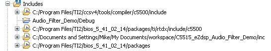

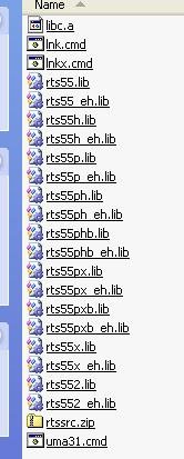

    John, Yes, I now understand that the library memory models don't match. Unfortunately, being a novice at this, I don't quite understand how to fix the problem. I don't know that I actaully "included" the library in question. There are several "included" files in my CC4 project that I do not recognize. I can only conclude that they were automatically added when I specified the C55xx as my target.
    Here's a screenshot of what is in my include files.
    From the above listing I do not understand how to switch the improperly included library file to the correct file. How would you suggest that I go about changing the improperly included file to the correct file?
    Here's the list of files in the "inc" directory:
    MikeH

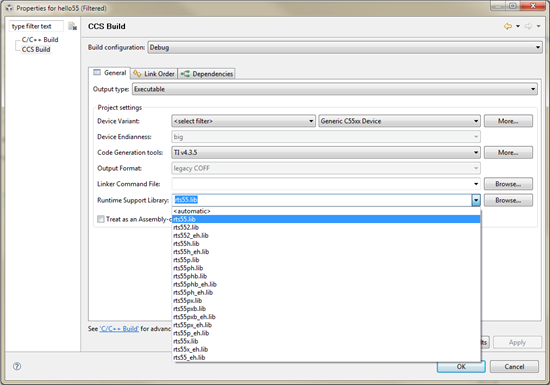

  • CCS will automatically select a library for you. But you can explicitly choose one by right-clicking on your project in the C/C++ Projects view and selecting Build Properties in the context menu. From there you can specify the runtime library you wish to use:
    ki

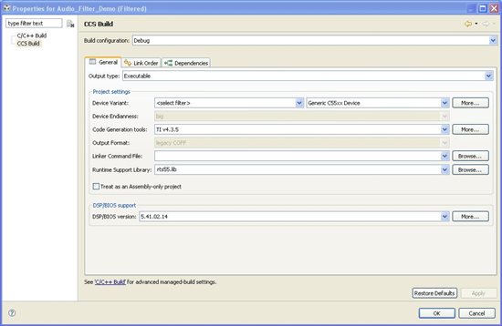

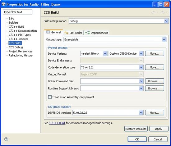

  • Ki,
    Thanks for the suggestion, but my Build Properties window does not list a runtime library, and will not allow me to select one. The drop down menu and Browse buttons are inoperable. Am I looking in the correc place? Also, we appear to be using different version of CCS4, unless I am looking at the wrong config window.

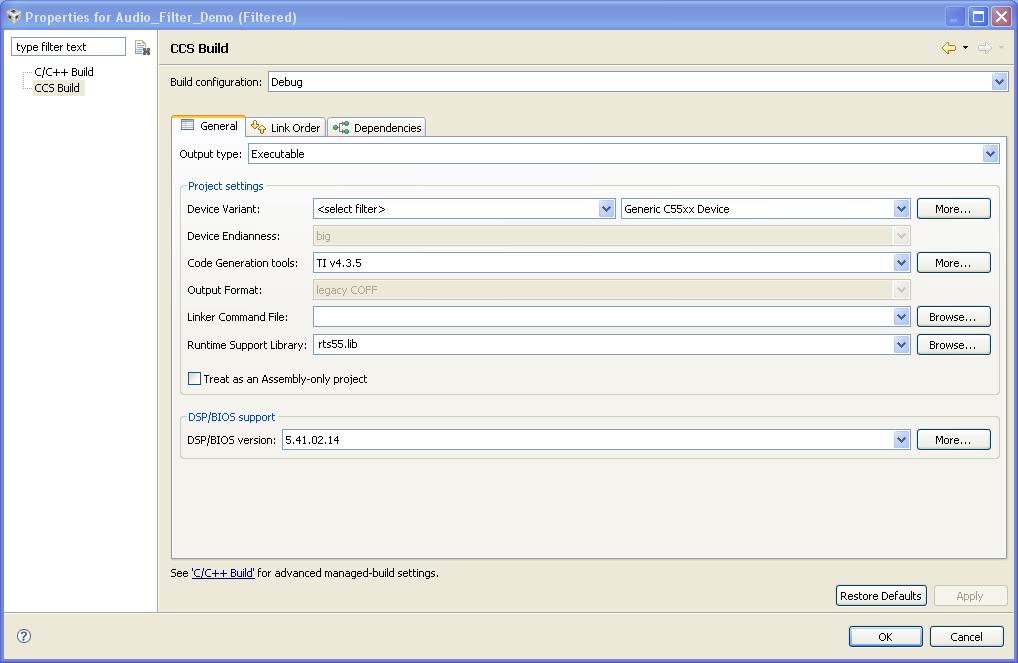

  • Looking at your BIOS and CGT version, you definately do have an older version of CCS. Mine is 4.1.2 (latest).
    Anyway you can also simply use the 'Browse' button and select the library that way if the drop down is empty (should be in: \ccsv4\tools\compiler\c5500\lib)

  • Yes, I am using 4.1.0 since 4.1.2 caused an unresolved installation problem on my machine.
    I have discovered that the Runtime Support Library drop down menu and browse buttons are not activated until you select Device Variant first. Then you can select a library from the drop down menu.

  • The v5515 option isn't available in the 4.3.5 compiler, it first shows up in 4.3.6.  You can download 4.3.6 via update manager.  If you want to stick with the 4.3.5 compiler use the v5505 option instead.  This option lets the compiler know which version of the C55x core is being used.
    As far as RTS libraries for me when I run through the wizard the RTS library is set as <automatic>, with this setting the linker will choose the appropriate library based on the other build options that I have set.
    You likely want your options set to large memory model.  In the build options go to "Runtime Model Options" and check the box for "Use large memory model".  Then go to the linker options and go to "File Search Path".  The top box is where you specify which RTS library to use.  If there is a libc.a there it means that the automatic selection is on, if it is blank click the + icon and select rts55x.lib.  Normally the memory model is setup automatically by the project wizard when you select a specific device like 5515 but unfortunately 5515 doesn't show up in that list yet.
