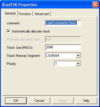

Here's what I do.  First I create a task in the BIOS GUI:
This in turn generates several files.  The structure itself is declared in bioscfg.s28 (i.e. assembly):

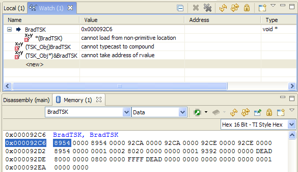

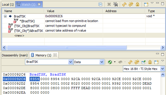

I haven't been able to figure out a way to view that object!  Here's a screenshot of things I tried and the corresponding memory:
Any other ideas?

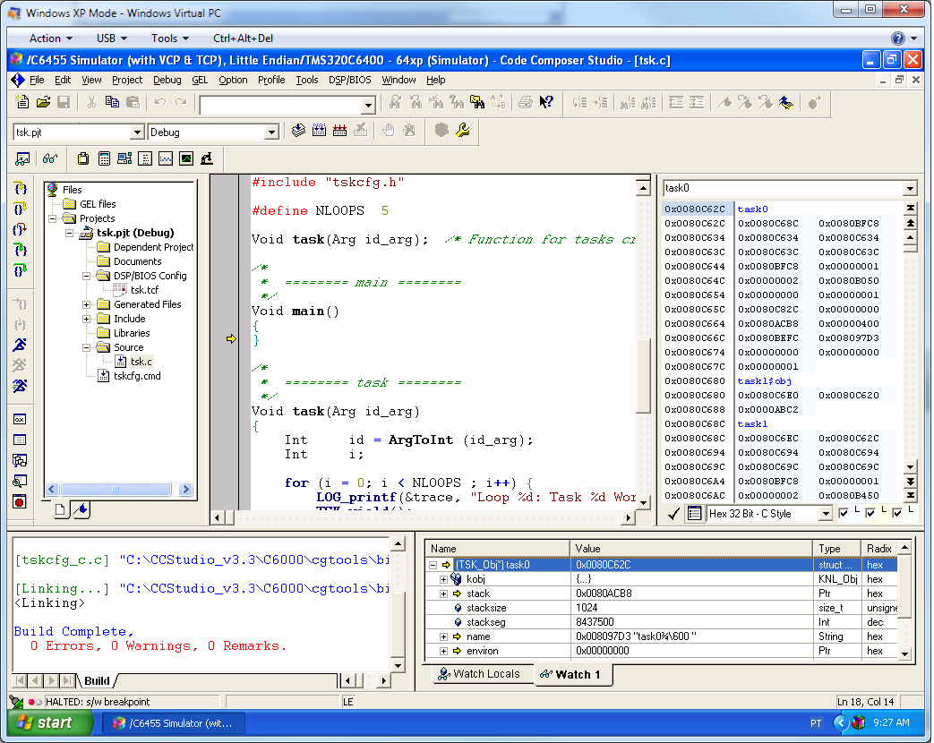

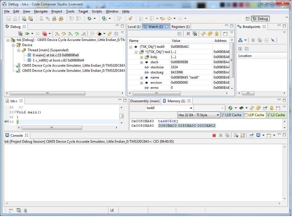

    Similarly to CCSv3.3, CCSv4 also requires the typecast conversion before the variable name. The post you sent before has a nice explanation by Darian to why this happens.
    I see above that you tried several combinations of typecasts but one: (TSK_Obj*) BradTSK
    This way BradTSK will be correctly treated as a task handler and show the correct elements.
    You can see in the screens below.
    I don't know why, but the typedef TSK_Obj defines TSK_Obj and TSK_Handler*, therefore I wonder if CCS gets confused by that...
    Hope this helps,
    Rafael

  • Brad,
    I did some experimenting. I defined a local variable as TSK_Obj and it was correctly identified as a struct TSK_Obj type.
    I also noticed that  CCSv4 reads BradTSK as an address instead of a variable - maybe because this variable is not explicitly defined in the source file (but via a .h file). I could file an enhancement to maybe increase the scope of verification for the watch window.
    The correct modifier and typecast should be *(TSK_Obj*) BradTSK (it works, I verified). Therefore the typecast I sent before seems to be a bug, but I am not sure if it kills to leave this "feature" as it is, since CCS recognizes both forms and gives the correct result.
    I am still checking some other things but please let me know your comments, ok?
    Just FYI: CCSv3.3 also behaves that way...
    Cheers,
    Rafael

  • Rafael,
    Thanks for your help on this issue.  I believe it makes sense and we can mark it resolved.
    I think the issue ultimately is due to the fact that BIOS defines:
    _BradTSK = BradTSK
    This is a special/rare case where 2 versions of the same name exist, one with the underscore and one without.
    As far as I can tell, when you type a symbol into the watch window it will first attempt to match that symbol against all the assembly labels, and then it will try to prepend a leading underscore (i.e. treat it as C) and match it against those assembly labels again.  So when I typed "BradTSK" into the watch window I really intended "BradTSK" to be the name of a C structure.  However, since a label already exists called BradTSK it matches that first.
    A different way that works that might conceptually be easier to understand is to type "_BradTSK" into the watch window.  In this case it is obvious to both the user and to CCS that _BradTSK is the name of an assembly label (i.e. there is not an __BradTSK too with two leading underscores).  Since _BradTSK is a label/address it is obvious that it is the address of a TSK_Obj, i.e. a TSK_Obj*.  So the alternate way that you can write in the watch window is:
    (TSK_Obj*)_BradTSK
    It's been a long day so hopefully that explanation makes sense to everybody else!
