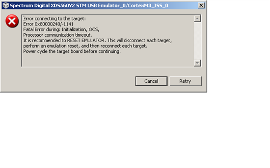

    For the second error, when I try to reconnect, I get the following error message popping up and I cannot reconnect CCS. I need to power off/on the Netra EVM, reconnect and reload the program.
    Ki-Soo Lee said:
    Thus it is recommended to reset your environment and reload the program.
    How can I reset emulator instead of power off/on the EVM?
