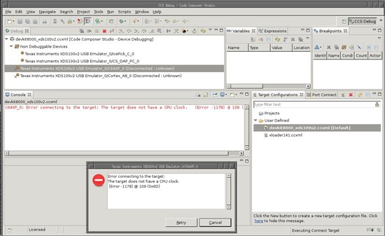

"Error connecting to the target". ccsv5 on linux, XDS100v2 JTAG adapter, devkit8000 Cortex-A8 OMAP3530 target board.
Other Parts Discussed in Thread: OMAP3530, CCSTUDIO
I am running ccsv5 (5.0.1.00036, with its included Eclipse; Help shows it as "Code Composer Studio  Version: N201101102000") on a linux host. This debian 6.0, 32-bit  AMD, host is connected, via USB, to an XDS100v2 JTAG adapter. The latter is connected to a devkit8000 target board (ie a Beagle Board clone, with a Cortex-A8 OMAP3530 core); both were manufactured by Embest (armkits.com).
The host can talk to the JTAG pod (xds100v2), as confirmed by the dbgjtag utility (which comes with ccsv5). (See the bottom of this post, for the log.) But I have not been able to get ccsv5 to connect to the c64xp or the cortex-a8. The c64xp connection complains:
Error connecting to the target:
The target does not have a CPU clock.
 (Error -1178) @ 109 (0x6D)
And the cortex-a8 connection hangs eclipse.Below, I will take you thru the steps I followed to get to these points.

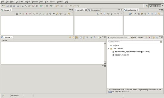

Starting eclipse, the initial screen looks as follows:

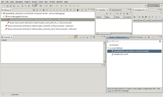

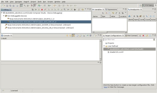

Then, in the above Eclipse window, in the Target Configurations view, I select the default target (devkit8000_xds100v2.ccxml) with the Right mouse button, and choose Launch Selected Configuration from its pop-up menu. After a bit of processing, this results in
Then, in the Debug view, I select the IcePick, using the mouse Right button, and run Connect Target. After a moment, it seems to succeed:
Then I do the same for the CS_DAP, which seems to succeed as well:
The next one, for c64xp, fails as follows:
Never the less, I try connecting to the Cortex-A8 anyway, but that simply hangs Eclipse! My ckermit serial console to the target hangs as well; only a power cycle gets me out of it. (Eclipse needs a C-c, or SIGHUP, to exit, of course.)

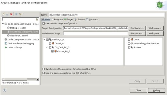

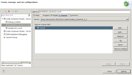

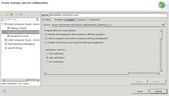

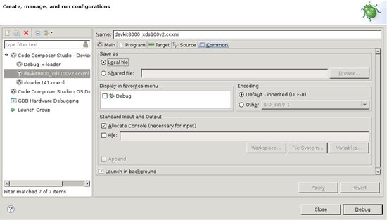

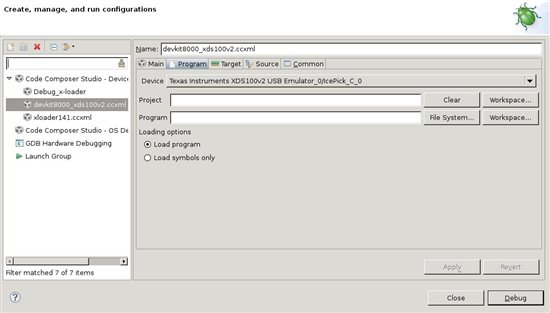

Though the .ccxml file should/may suffice, I will show some some screen grabs of its configuration anyway:

The following observations should also be of interest.
I ran 'strace eclipse', and noticed that, when the hang occurs, it is trying to access
stat64("/usr/local/CCSv5/ccsv5/ccs_base_5.0.1.00036/DebugServer/bin/linux_ia32/LinuxDriver.dll", 0xbfb87448) = -1 ENOENT (No such file or directory)
Is this a remnant of Windows code? That directory lists only
him@interzone Thu Feb 24 10:46:19 CCSv5> ls -l /usr/local/CCSv5/ccsv5/ccs_base_5.0.1.00036/DebugServer/bin/linux_ia32/
total 3580
drwxr-xr-x 2 no9 no9   4096 Feb 14 15:55 SerializedProfileActivities/
-rwxr-xr-x 1 no9 no9  95275 Jan 21 23:17 drive_ofs*
-r--r--r-- 1 no9 no9    161 Jan 21 23:17 drivers.ini
-rwxr-xr-x 1 no9 no9  53483 Jan 21 23:17 libBkptCollector.so*
-rwxr-xr-x 1 no9 no9 124540 Jan 21 23:17 libCCSnowFlash.so*
-rwxr-xr-x 1 no9 no9 901202 Jan 21 23:17 libCollectorServer.so*
-rwxr-xr-x 1 no9 no9 362761 Jan 21 23:17 libDatasetServer.so*
-rwxr-xr-x 1 no9 no9  79763 Jan 21 23:17 libFlash28xx.so*
-rwxr-xr-x 1 no9 no9  22590 Jan 21 23:17 libFlashStellaris.so*
-rwxr-xr-x 1 no9 no9   4032 Jan 21 23:17 libLibraryLoader.so*
-rwxr-xr-x 1 no9 no9 455111 Jan 21 23:17 libLinuxDriver.so*
-rwxr-xr-x 1 no9 no9 556087 Jan 21 23:17 libtiofr11.so*
-rwxr-xr-x 1 no9 no9 152649 Jan 21 23:17 libtiofr_gnu.so*
-rwxr-xr-x 1 no9 no9 494909 Jan 21 23:17 libtiofr_tial.so*
-rwxr-xr-x 1 no9 no9 182755 Jan 21 23:17 libXPCOMUtility.so*
-rwxr-xr-x 1 no9 no9  94105 Jan 21 23:17 ofs_dump*
him@interzone Thu Feb 24 10:46:22 CCSv5>
(The executability is, IIRC, another such Windows artifact as well.) However, desparately creating a soft link
  ln -s libLinuxDriver.so LinuxDriver.dll
did not help anything.
FYI, during the c64xp connection failure, the following echoed:
stat64("/usr/local/CCSv5/ccsv5/eclipse/plugins/com.ti.ccstudio.debug.server_5.0.1.201101102000/com/ti/debug/engine/dialogs/IBaseDialog$IconType.class", 0xbfb86f30) = -1 ENOENT (No such file or directory)
However, this seems more informational than functional -- unless if a debug plugin is needed.
him@interzone Thu Feb 24 11:08:24 linux_ia32> ls -l /usr/local/CCSv5/ccsv5/eclipse/plugins/com.ti.ccstudio.debug.server_5.0.1.201101102000/com/ti/
total 4
drwxr-xr-x 3 him him 4096 Feb 14 15:58 ccstudio/
him@interzone Thu Feb 24 11:08:32 linux_ia32>
him9@interzone Thu Feb 24 12:11:24 Xterm.log> uname -a
Linux interzone 2.6.32-5-686 #1 SMP Wed Jan 12 04:01:41 UTC 2011 i686 GNU/Linux
him@interzone Thu Feb 24 12:11:26 Xterm.log>
That's all the info which I can think of. My original goal was to break into x-loader, and dump some data/variables, that's all!
Thanks for any help, tips or commiseration which anyone can provide.
