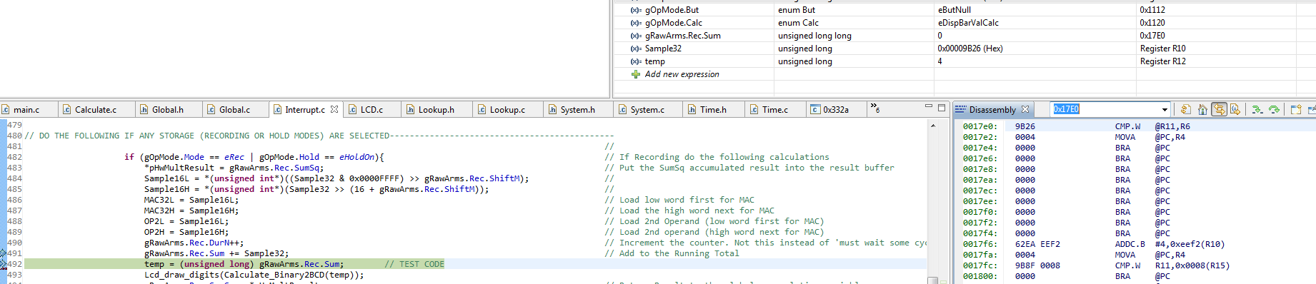

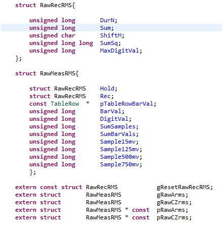

I am having difficulties when assigning values to 'long long' types within structures. Code with structure members of 'long' type compiles and works but when the member type is changed to 'long long' type it compiles without error but no longer assigns values to the member. Specifically the simple line:
gRawArms.Rec.Sum++;
works for:
but not for:
Ideas would be helpful.
-B

  • I can confirm that the problem is partially with expressions view not updating however the actual values are also not correct in memory at times. To start if the long long is initialized with '0' rather than '0x00000000' garbage may remain in the lower 32 bits. In addition on the first call to move a 64-bit long long number from a GP register to the memory location of the storage variable extaneous LSBs are also appear to be added.
    After adding the first one:

    I am also seeing inconsitencies when moving long long variables from GP registers into main memory. I am seeing these inconsistancies *within memory view in the disassembly window* (see above message). No one has yet mentioned any bugs that cause this view to be corrupted. Is this view corrupted too? If so, there is no way (neither expressions view nor disassebly view) that can verify code involving long long is working properly. I need to fix this problem urgently.
    Hopefully this is a non-issue and I have instead made a silly interpretation error. I am checking on that possibility now...
  • Yes this was my interpretation mistake, the memory and dissassembly view do contain the correct data. So the entire problem can be attributed to the Bug you mentioned and expressions view.
