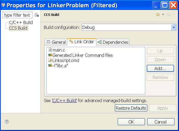

  • You need to change the order in which the linker sees its input.  Right now, I'm not sure why.  I'll find out and get back to you on that.  For now, I want to show you how to get going again.
    Bring up the project Build Properties.  Highlight CCS Build in the left panel.  Then click the Link Order tab.  Click Add, then Select All.  Click OK.  Then use the Up and Down buttons to make your file order look the same as the screen shot below.  The key is that the last two files are Linkscript.cmd and -l"libc.a".
    Thanks and regards,
    -George
  • George,
    Thanks for the reply...I have tried your advice above and the code links as expected.
    However with over 200 files in the software build hitting the Up/Down button that many times will cause users to go crazy.  I know that you are looking into this further and I am hopeful that you will a easier alternative.  We use the command line interface to generate the workspace and project, so hopefully a solution can be found to dictate order during workspace/project creation.
    Paul
