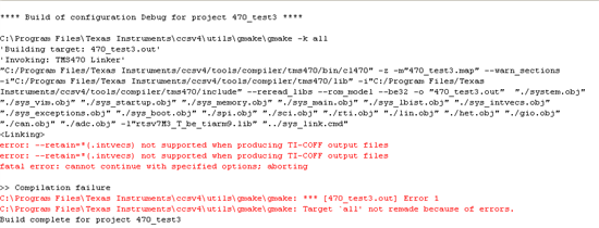

error: --retain=*(.intvecs) not supported when producing TI-COFF output files
I get a project of TMS470MF066 by HAL,then I compile the project ,but failed.
the message is "error: --retain=*(.intvecs) not supported when producing TI-COFF output files"
what is the problem?
thank you very much.
  • The explanation for the error is exactly as stated in the text: the --retain option is not supported when producing COFF output files. Your linker command file probably has this option specified and as you can see from the build output, since there is no specific ABI option in the build options, the default is COFF output.
    You can change the ABI to eabi and that will get rid of the error (and ofcourse produce a ELF output file). You can do this from Project Properties->CCS Build->Output Format, and set this to eabi(ELF).

    But I still feel confused.It also display the error.
    That is the detail below.
    related cmd file code by HAL:
     -l rtsv7M3_T_be_eabi.lib
    --retain="*(.intvecs)"
    --retain="*(.vim_table)"
    related setting of  ccs:
    I have selected 'Elf Parser' once,the error still there.
    what is the difference between TI-COFF and ELF?which one should I choose?
    Tahnks again.
  • It seems that you are using an older version of CCSv4 where the ABI setting is not available from the Properties->CCS Build->General tab ( as seen in your screenshot). In this case, you can go into Properties->C/C++ Build->Compiler->Runtime Model Options and set the ABI to EABI from there.
    The Parser setting can still be left as TI Coff Parser.
