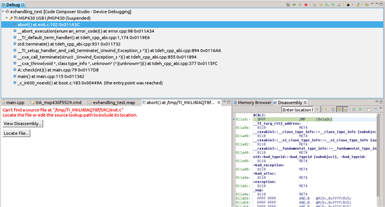

I am developing a C++ application based on the MSP430.  I have found a problem with exceptions handling that I can reproduce using the following code snippet:

When the object is instantiated statically the catch works fine (I tried also with mere functions and it works fine too).  The problem is when I do dynamic instantiation, either with a raw pointer or a smart one: the program will re-start.  I have also tried making the class copyable.  The --exceptions option is enabled.
What am I missing?
Many thanks,
Pibe
  • Another piece of information: if I try compiling with --lc (large code model) option the results are the same.  If I add --ld (large data model) all three cases fail.
    I have tried re-installing CCS and obtained the same results.

  • Here it is a screen capture for the raw pointer throw fail:
  • Found it: it was the heap size.  It comes with a minute 160 bytes, I increased it to 400 and voila'!
