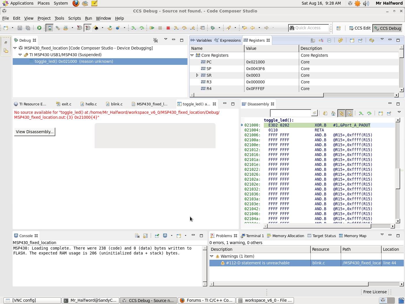

I wrote a function for flashing code in Banks A and B of a MSP430F5528. I wanted to locate the function at a specific location in Bank D. The code is generated and loads through the debugger where I want it. The function call to this code looks to be formed properly when disassembled. However when the call is executed the PC steps right over the function call as if it was not there. I can not set break points in the function however I can see it clearly by looking at the specific location using the memory viewer at the specified address .If I force the PC to point at the location the code executes properly, but CCS reports there is no source code for that location. If I remove the #pragma LOCATION directive and allow the code to be placed anywhere, all works as expected. I tried this using CCSV5 and today I downloaded CCSV6 the exactly the same results. I am using the mspx option, and by the way when the code is allowed to be stored where it wants the address is beyond 0x10000 address. So what am I doing wrong?

    Do you mean that the function code is not executed at all? Or just that the debug actions (step into etc) do not seem to follow the code execution? Would you be able to send us a simple project that can be used to reproduce the issue? That could help us identify if it is a compiler issue or a device/hardware issue and allow us to redirect the issue to the appropriate forum.

    The attached project 4682.MSP430_fixed_location.zip is an attempt to re-create the problem, targeting a MSP430F5528 using CCS v6.0.1 and MSP430 compiler v4.3.3.

    I didn't get exactly the same behaviour as you, since found that:
    1) When run outside of the debugger the LED flashes, so the code is running OK.
    2) In the debugger when attempt to "Step Into (F5)" the toggle_led function the debugger steps over the function.
    3) In the debugger when "Assembly Step Into (Shift+Ctrl+F5)" into the toggle_led function the debugger does step into the assembler of the toggle_led function in the address 0x21000 in flash, however the the debugger reports there is no source available for the toggle_led function:
    Therefore, it appears that the #pragma LOCATION is correctly placing the function at the requested address, but something goes wrong with the handling of the symbolic debug information. Not sure if the problem is in the debug information generated by the compiler, or the processing of the debug information by the CCS debugger.

    I was able to observe the same behavior. The code does execute correctly and you can step into it using the Assembly Step Into, however CCS does reports that there is "No source available for toggle_led....", so it looks like there may be something going on in the way the debugger is processing the debug information associated with that function.
    I have filed a bug against CCS for this to be looked at and analyzed further. The tracking # is SDSCM00050764. You can track its status using the SDOWP link in my signature.
