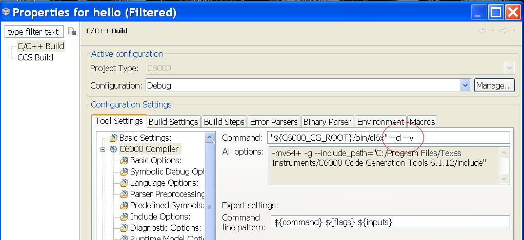

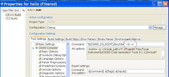

  • I have seen this before.  Yet I have never figured out the root of the problem.  I can offer three options.  Choose the one you think most likely to work.
    Option 1: Add some debug options to the build which cause the compiler to issue lots of information about how the build is proceeding.  Then post what you see here.  We might be able to diagnose the root problem.  The options are: --d --v .  Because they are debug options which are not exposed like the usual options, you have to take a special step.  Bring up the Build Properties window and hand enter the options in the "Command" box.  Here is a picture.

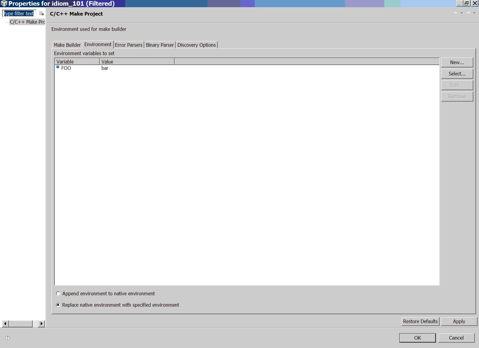

    And then, here is how to replicate it in CCS 4.1.2, when building a C/C++ Make Project:
    With the configuration above, the build fails. Adding TMP, but still keeping the option "Replace native environment" or checking "Append environment" makes the build succeed.
