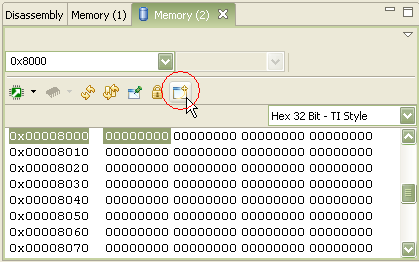

I have noted a couple of things that could be improved. Not sure where to put it:
- I get disconnected from the target when I use Skype with USB headset.
- I can only open one memory window in CCS GUI. That's a bit restrictive and it would be better to be able to open as many as I want.
