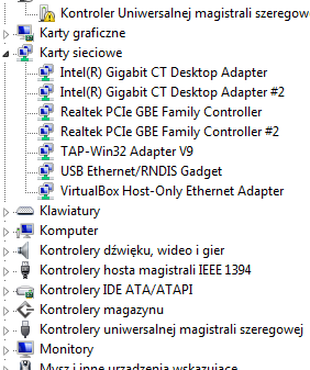

    Also, could you provide the snapshot of the Device Manager - Network Adapters.
    Divya
  • Hi Divya,
    Connecting the Light Crafter using USB hub didnt change anything but I only have a passive USB hub (this can be a problem). I enclosed a screenshot of device manager.
    regards,
    Marcin
  • Marcin,
    Your Device Manager is showing that the RNDIS driver has been properly installed. This the way it should look. When you unplug the LCr USB while watching the Device Manager, do you see the RNDIS driver disappear after a few seconds?
    We have tried several passive USB hubs which have worked, when it was not working when directly plugged into the PC USB port. So, that shouldn't be a problem. In fact, the DM is showing that the LCr is being recognized and the driver registered. You should then be able to connect to it from the LCr control program. If that is not possible, then something else is wrong.
