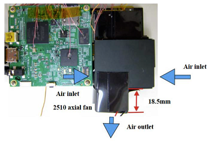

 I contacted Young Optics to ask them about a way to actively cool the LCr. They suggested me a given fan that I purchased (Sunon MC25100V2). However, the LCr seems to be unable to provide enough current to power the fan (0.43W). Do you know what is the power provided by the fan connector pins (I checked that the voltage was actually 5V)? I should add that I have the power supply that was recommended (EMSA050300-Z12P) and that is capable of  powering up to 15W.
