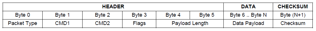

    The command response packet is described in the DLP® LightCrafter™ DM365 Command Interface Guide section 2 Packet Structure. You can categorize commands into two basic groups namely WriteCommands and ReadCommands. For the write commands the response packet will be short and for read type commands the response packet will include the information requested in the payload.
    Now below ones are 'write type' commands.
    fwrite(tcpObject,uint8(hex2dec(['02';'01';'01';'00';'01';'00';'00';'05']))); %switch display mode to static
    fwrite(tcpObject,uint8(hex2dec(['02';'01';'03';'00';'01';'00';'00';'07']))); %switch to internal pattern: checkboard
    Logic to read the response -
    a. Read 6-bytes header
    b. Check Byte0/Packet Type value verify it is returing what is expected, for example - 0x02 write command the response would be 0x03 - write response similarly if it is 0x04 - read command then it will be 0x05 read response. In case if you receive 0x00 - Busy or 0x01 - Command Error Packet then command not executed successful either LightCrafter busy not ready to accept command or your command packet itself has eror in it.
    So, follow the documentation and analyze 6-bytes HEADER.
    The next step would be to determine how many number of bytes to read, which will be "Payload length" + 1 for check sum. You can simply read  [(Byte5<<8+Byte4) + 1] number of bytes.
    Also validate correctness in the packet by running checksum calcuation
    Checksum = (Byte_0 + Byte_1 + … Byte_N-1) MODULO[ 0x100 ] where Checksum byte is last byte Byte_N
