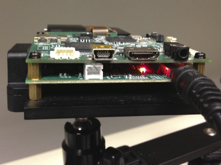

  • A known workaround for this problem is to remove all power from the device (including the USB connector) and then reconnect the power.
    I have encountered the same problem as Jakob where after installing the MSP430 firmware, the DLP Lightcrafter is unable to be powered on.  Similar to his situation, the device powers off after booting.  The green LED next to the power plug remains on while the red LED flashes once every 5 seconds.  In this state, if either the power plug or USB are connected, the device will remain in this state.  If both are removed, the device fully powers off.
    I'm not sure how to attempt the workaround mentioned above, because the device fully powers off once the power plug and USB are both disconnected.  Because of this problem, I am unable to connect the device to the Lightcrafter GUI, and thus cannot restore to an earlier version of the MSP430 firmware.
    Any help you can offer to resolve this issue would be appreciated.
    -Nathaniel
  • Nathaniel,
    When you say that the red LED blinks every five seconds, how long does the red LED stay lit? Also, have you made any hardware modifications to the LightCrafter?
    Blair
    The red LED stays on for 5 seconds at a time and blinks off for about half a second.
    No hardware modification have been made to the device.  The only changes made have been to the Lightcrafter firmware.
    -Nathaniel
  • Nathaniel,
    I believe the root cause of  your problem may be your power supply. In the 2.6 version of the MSP430 firmware we added some new diagnostic tools. One such tool protects the LightCrafter from under- and over-voltage situations and notifies the user with the LED's blinking in the way you described them.
    Do you have another wall wart or bench top power supply that you could try with your LightCrafter?
    Blair

  • Blair,
    I ran into a problem after upgraded to MSP430 v2.7. After the splash screen was shown, instead of showing the color bar pattern, the Lcr would shut off. At this point the power button was not responding, I had to disconnect USB cable and power supply before Lcr would reboot again, which will again shut off after the splash screen.
    The power supply has a output spec of 5v 1.5A.
    Thanks for your help.
  • Hello Bing Ouyang1,
    Do you see any blinking lights on the board when it shuts down? Also, have you modified the board or removed the light engine?
    Blair
  • Blair,
    Yes the light was trying to turn green to red when it shuts off.After lcr shut off, the was a light on the second level board besides the power supply was still blinking. All lights on the top level was off.
    We did remove the light engine. Is that what's causing the issue?
  • Removing the light engine when the MSP430 version is 2.6 or 2.7 causes the LightCrafter to shut down. The next Software Bundle release will allow the light engine to be removed.
    For now, you need to reconnect your light engine and install v2.5 of the MSP430 firmware from version 1.1 of the Software Bundle. You do not need to change any of the other firmware. The GUI will tell you to upgrade the MSP430 firmware and notify you about a version mismatch, but you can ignore those warnings.
    Blair
  • Ok, will do. Thanks a lot!
