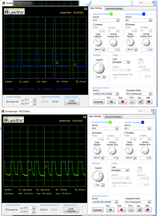

I measured the RGB light frequency and found out that:
1)  RGB light source has period of about 4.27ms (+/-240Hz)
2) The Blue LED has one pulse and Read and Greed have two pulses per period
According to the "DLPC300 programmer's guide" the frame rate should be 60Hz, it means that for each frame there are four sequences of RGB impulses with total 4 impulses of Blue LED and 8 impulses for Green and Red LEDs.
I would like to know why the LEDs turned on and off more times per period? To me it seems more logical to turn them on only once per period. On figure below the Blue LED (blue curve) and Green LED (green curve) activity is shown.

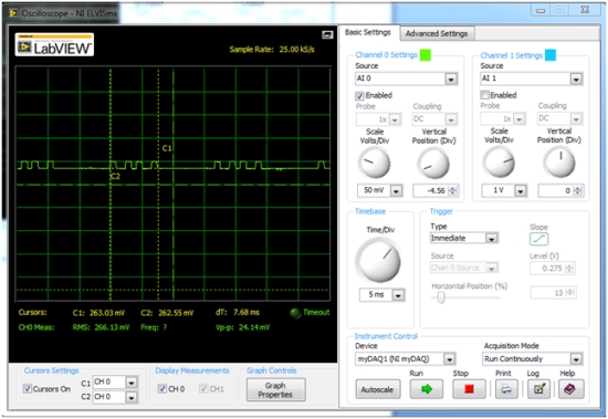

Another interesting thing is that when static image of video is loaded to DMD the LEDs are active only for a half of the period and the second half of the period they are either in off or on state. On the picture below green static image was loaded to the DMD and reflected light activity was measured. As it can be seen for half of the period all mirrors/LEDs are off. Why would you need to keep LEDs/mirrors of for half of time?

    Please provide the information on the Modes you are operating, from your description i am assuming you are attempting a) Static Display Mode b) HDMI Video Mode (driving external video source), correct me if it is wrong.
    The DLPC300 in these modes, run what is called as Normal Video sequences, these display sequences, this is described in Programmer's Guide Table 2-80. DLPC300 16-, 18-, and 24-bit RGB External Video Sequences, note here, they have allocated different % of time for displaying data for each channel, 35% - Red, 45% Green, 20% Blue. The sequences are designed for producing good image for viewing by human eyes. So if we were to follow the Figure 2-7, for displaying, it will create what is called as "PWM Artifact", to reduce such a thing, the incoming RGB 888 pixel data is shown multiple times and in the specified dutycyle % (display time) for the channel.
    Note, the video sequences are designed for specific LEDs, LED driver on/off timing characteristics, (in this case for whatever hardware used on the Kit), if you replace the LEDs or the LED driver it may not produce good image.
    Now there are other modes, Pixel Accurate mode, where it will not do so (uneven repeating showing odd pulses between Red Green and Blue), as explained in 2.3.1.1.2 Pixel Accurate External Video Sequences.
    Sanjeev
