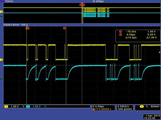

    Using a scope to probe the JTAG lines on my board, I see that TDO (from the DSP) has data on it in response to the emulator, but I don't know the JTAG comm protocol, so I haven't been able to interpret it. I will say that the TDO line "looks odd", in that some of it's rising edges are extremely slow, while others are sharp. Does your TDO line look similar? In this picture yellow is TDI and blue is TDO, captured while CCS is displaying the error message dialog from the connect operation.

  • Hi Craig, The error code I've got is also 0x8000240/-1146. Does that mean we've got the same problem? I have turned to the technical support of Spectrumdigital in this morning, and I am waiting for their answers. The TDO line you've got looks really somewhat "odd", I don't know what dose it mean either. But, It looks like that your scope is in AC coupling mode, am I right?
