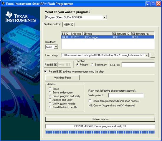

    Using the SmartRF Flash programmer, the CC2531 information page can be read like this.
    Install the flash programmer
    Open program
    Select program CCxxxx SoC or MSP
    Perform your workaround procedure.
    Now the CC2531 should be detected and the screen should look something like this.
    Select the CC2531 and press “View Info Page”
    The resulting screen should look something like this.

    I was able to get the information page to pull up, but I'm not able to save the data from the window. Here's a screenshot of the information page for the device in question.
  • Hi Doughy
    This content on this information page is causing the problem.
    We need to know the supplier of these chips to investigate root case for this problem

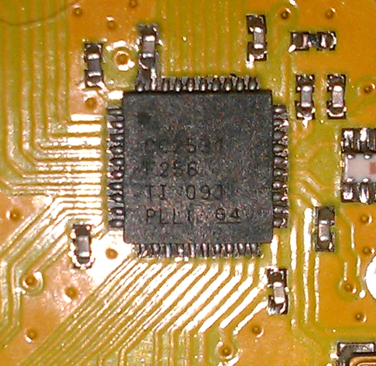

  • Hi again,
    here is the photo of the my 2531.
    Mirek

    I am posting another photo of  bad chips.
    Mirek
