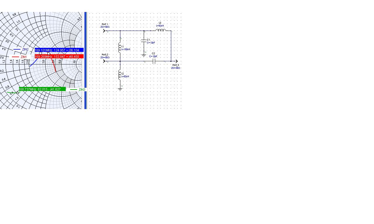

  • Hi guys
    Pls.  comments regarding below simulation plot for  CC1120 balun-unbalun  impedance on 164-174MHz.

  • Dear TER
    I also need in  PA IZout opt. impedance data for the 164-174MHz frequency band. It is necessary  for the external power amplifier matching circuit calculation .
    If you saw  above my post from 19.12.2011 you also may see that output  balun impedanse (green line) is far from 50 Ohm and require additional matching for the external antenna switch, which I'm planning to use in my design .
    If I use elements 0603 instead 0402 and PCB thickness 1.5mm,  impedance also go out from reference design and it needs in correction and simulation.
    Vlad
  • I agree that optimal load for the different frequency bands should be in the datasheet.
    What we have seen in the past is that it is very common to use wrong reference plane when using provided s-parameter files.
    One approach is to simulate our reference design using 50ohm ports and when making your own design with different components and PCB thickness aim to keep the same impedances when simulate it in the same way as you simulated the ref design.
