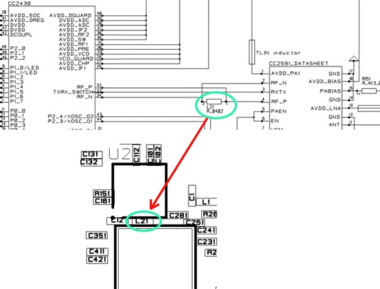

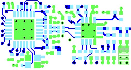

    In the "CC2530_CC2591EM reference design" the input to cc2591 the "Complex Impedance Matching Networks", is very long. see photo 1. And has 7 component's between cc2530 and cc2591. that may be good for reference design, but in the real world , it take too big PCB space, and  make it near imposable to use the cc2591 if this PCB space must be wested.
    In demo reference design cc2430 and cc2591 it use only one coil, see photo 2. Can we use this reference design? and we can use only one coil between cc2530 and cc2591?
    I read in some RF guide paper, that : "If Traces Shorter than 1/20th λ Long, Zo Matching is usually Not Important"
    What I missed ?
    Photo 1: CC2530_CC2591EM reference design
     Photo 2: cc2430 and cc2591  reference design

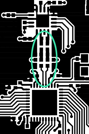

  • Nizim,
    I see you point, however the output stage of the CC2430 and CC2530 are so different that the same match could not be re-used. Here is a layout study we did not show that a compact layout can be acheived with a CC2530+CC2591 device. The match between the CC2520 and CC2530 is the same.
    /TA

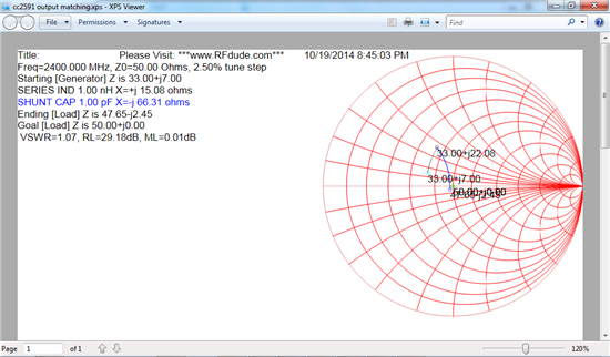

  • Hi everyone!
    I would like to build wireless project use cc2500+cc2591.I have known output impedance (RF-N -- RF-P) of cc2500 is 80+j74 and input impedance of cc2591 is 105+j35. So need to matching them.Use the Smith chart, i build matching circuit as the picture. I got VSWR for cc2500+cc2590: 1.14, VSWR in output is 1.07. IS this working good and properly?
