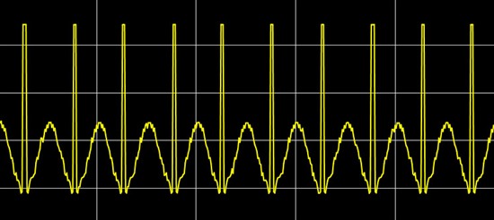

Please see the picture below,
I am converting a sine wave, the lowest voltage get "clipped off" and returned the highest possible ADC conversion number.
I am new in this field, is this a well known phenomenon that ADC tends to mistake the "close to 0V" as the "VREF" and return the highest possible number (for 12 bit, 4095)?  And how to deal with this?
Thanks!
  • Indeed, if I set any pin (for example, p0) as a single end input, and then use a wire to connect the ground pin to the p0, the ADC will return the highest possible number.  And if I set any two pins as the differential input, and then use a wire to connect these two pins, the ADC will return the highest possible number as well.
    This is done on the cc2510 mini development kit.  Really weird, why is that?
  • Hello Lei Chen1,
    As the responder to your previous post noted, the ADC data is a signed value which you need to convert using Two's complement.  You may want to consult a digital textbook or even wikipedia for some basic two's complement information if you need it.   The MSB of a signed value indicates whether it is negative or positive (0=positive, 1=negative).
    You note the value is 4095, which tells me you are treating the number as an unsigned value, however when treated as a signed number a value of all ones (1111 1111 1111) is equivalent to -1, so the value you are getting is actually correct.

  • Solved the problem finally,
    Quite simple actually, just add a sentence, "if adc<0, adc=0", so that "-1" will not be mistaken as the "111111111111".
    The sine wave I am sampling actually goes from 0V to 3V (well, at least that's what the function generator is supposed to do), so the ADC result should never goes below zero, although BugKing precisely pointed out the problem, I still do know why ADC went below zero.
