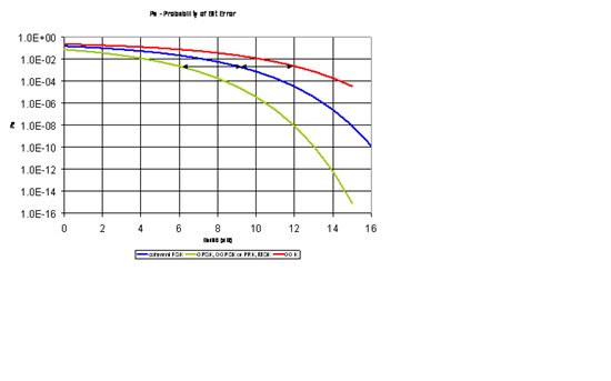

  •  Estimate the NF of an RX system by using BER
    By measuring a system BER performance for a given bit rate and knowing the RX filter bandwidth it is possible to solve for system noise figure. First we need to know calculate the back ground noise level over a given bandwidth. This determines the lower limit for sensitivity; the level is given by the thermal noise of a 50Ohm resistor at room temperature.
                                                                kTB = -173.8dBm/Hz
    Therefore if you are using a system operating at 250Kb/s using an RX bandwidth of 540KHz, the noise floor is calculated like below.
                                        Noisefloor = kTB*540000Hz = -116.5dBm
    Please note that the reason that you need a higher RX band with than the bit rate indicates is that you need to allow for fact that FSK and even GFSK modulation occupies more bandwidth that 1Hz for every bit/s transmitted. Furthermore we have to allow for XTAL tolerances.
    Now for each receiver type (FSK, MSK, QPSK etc, etc) a required signal to noise ratio can be calculated for a given BER. These graphs are typically called “Water fall graphs” because the BER drops quickly at above a certain Signal to noise ratio.
    This figure depicts BER as a function of signal to noise ratio of various receiver architectures; note that the performance of non-coherent FSK is 3dB worse than coherent FSK and therefore the same as OOK/ASK shown on the graph by the red trace.
     Most LPRF radios are specified at 1% packet error rate. Given a packet size of 20 bytes, the BER rate becomes ~0.006%. The type of receiver architecture that is used in most LPRF radios are based on a non-synchronous FSK receiver. From the water fall graphs the required Signal to noise ratio for an ideal FSK receiver is found to be 15dB at 0.006% BER. This information can be used to perform a simple comparison of the sensitivity given in a datasheet versus what a perfect system should perform.
    For an ideal system with no noise figure of its own the required signal strength @ 250KB/s becomes 101.5dBm. From the datasheet it can be found to be 87dBm. And therefore the total noise figure of the RX system becomes
    NF = 14.5dB
    The same equations can be solved for all combinations of bit rates and RX band width, what you will find is that the system NF does not change. This makes sense because its part of the system. Overall this NF number might seem high, but these systems are a compromise between power consumptions, linearity and NF.
