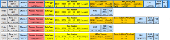

  • Thanks for your answer, but I have another question: looking at the connection event at channel 0x1F in the below figure
    what are the yellow packets which don't have PDUs on them? are these the packets to maintain the connection? Do I have to take them into consideration when calculating the number of bytes that can be sent in a connection interval?
    Thanks in advance
  • I do not see the picture because I'm on my mobile phone but they can be ACKs or polls, depending on your app.
    I do not think there are keep-alive packets in BLE but if I do not remember wrong, the connection events start with a poll.
    I would not take them into account. In fact, for rapid througput calculations what I do is to take all the packets in a connection event during a second, divide the whole number by two (to discard this short packets). and multiply for the number of bytes.

  • Hi Hafiz,
    A connection event consists of both initiator and peripheral Rx/Tx periods. I.e. they switch back and forth. You can see from the timestamp that they occur 295 µs after the previous packet. This indicates that they are sent by the reciprocating device within the same connection event. Hence they are not interesting for calculating write speed, as they have no relevance.
    LLID of 1 indicates empty packet or continuation packet. In this case empty as pdu len is 0.
    See the bluetooth core spec (http://www.bluetooth.org/docman/handlers/downloaddoc.ashx?doc_id=229737) Volume 6, Appendix B, Chapters 2.4 and 4.5.6/9 if you are interested.
