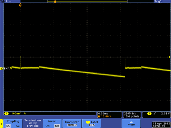

    Also, some more investigation today.  We scoped-out the DCOUPL pin.  We're measuring 1.917V.   Not seeing any significant noise or any differences compared to the KeyFob reference eval board.   See attached screen capture.

  • Oops... attaching scope screenshot.  This is DCOUPL pin during advertising mode.
    Brian
