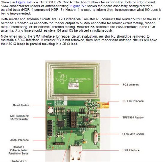

     first of all , sorry for my delay response basically i was struck somewhere else and also i was going through various pdf that i can find about TRF7960 and was analyzing the evm in lab through spectrum analyzer , now i am able to Conclude many things and looks like i have found a way of doing my job which is like this:
    1.) I will use extrernal antenna with evm , now for that as shown in image (from user manual ) For this i am able to conclude i need to remove Resistance R3 and and also R5 Resistor.( see if i am correct here regarding R5 resistor ?)

  • 1. Yes, you should remove R3 and R5.  R5 should not be populated by default.

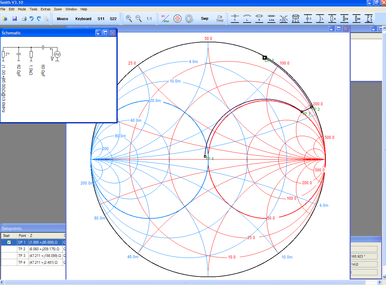

    2.  Correct, your matching circuit should match the antenna to 50 ohm impedance.  You can use a smith chart simulator program to get rough values.  You can find a useful smitch chart from the link below.
    http://fritz.dellsperger.net/

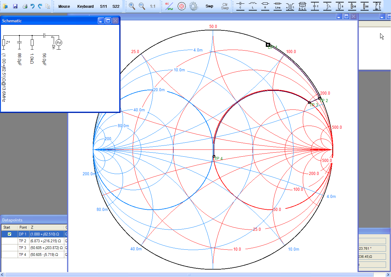

    3.  It is generally best to aim for about 1uH inductance of the coil and then adjust your tuning components.  For 300mm x 3mm antenna, I suggest 2 turns with  0.4mm trace width.  According to the calculator tool below, this should result in about 969nH.  You can convert this to the approximate complex impedance by using the formula 2*pi*fL.  This equates to ~ 1 + j82.51.  I have plotted this with the smith chart software and came up with tuning values.  This plot and tuning values are attached.  Please note that this is all based on calculations and will likely not be a perfect match.  It is best to measure the complex impedance of the antenna coil @ 13.56MHz using a network analyzer.

  • For 300x300, I suggest 1 turn with 2mm trace width.  This should get you close to 1uH.  I have attached one suggested tuning plotted on the smith chart.
    I suggest using copper.  The calculations are based on an copper PCB.  You could also build this antenna with copper tape and be pretty close to the calculation.
    Yes, you can adjust the trace width to increase/decrease inductance.  I would not worry as much about the trace spacing.  It is generally acceptable to use the same trace spacing as your trace width, but in the case of an antenna with such large dimensions, it will only be 1 turn anyway.
