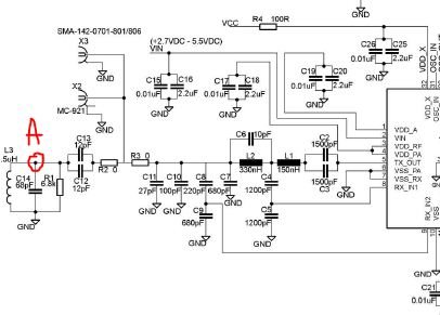

  • I've just changed the TRF on my prototype board with a new one and I still have the same issue. I'm following this schematic:
    I've the 13,56MHz sine wave at point A (about 25Vpp) and while checking it with my oscilloscope I may write the CSC register from 0x21 to 0x01, reading it back and the sine wave will be still present, rather than go to zero volts as I expect to see.

  • Axxe -
    do you have any screen captures of the register reads and writes? you may not consider it a priority and i appreciate that, but it seems that this should be working for you - so would like to help. also, what does rest of ckt you are using look like? any pix or drawings you have might help.

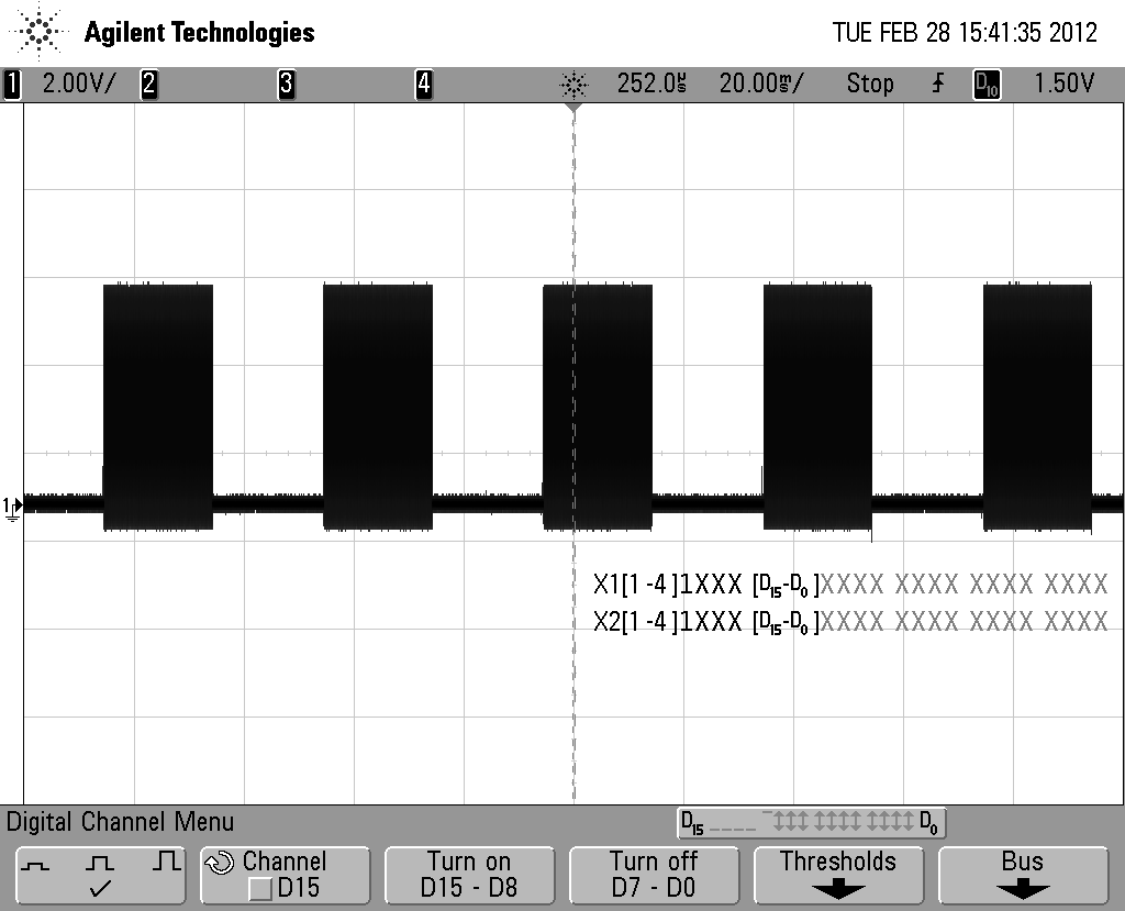

  • Hello Axxe,
    I tried to reproduce your issue, but I am not able to get your result.
    I wrote a little test application to verify your issue on my prototype where the workflow is :
    1.) Direct Command for RF Initial Collission avoidance -> carrier sense + RF On
    2.) Start Timer 20ms and wait for timer expiration
    3.) Read Chip Status Control Register (0x00)
    4.) Set rf_on = 0
    5.) Write back Chip Status Control Register (0x00)
    6.) Start Timer 20ms and wait for timer expiration
    As you can see in the attached oscilloscope image, the rf field switches on/off every 20ms.
    I am not sure if my case is compareable to yours as I am  going to use the TRF as NFC Initiator/Target device.
    What steps do you perform before you try to turn off the rf-field?
    Kind Regards
    Marco
