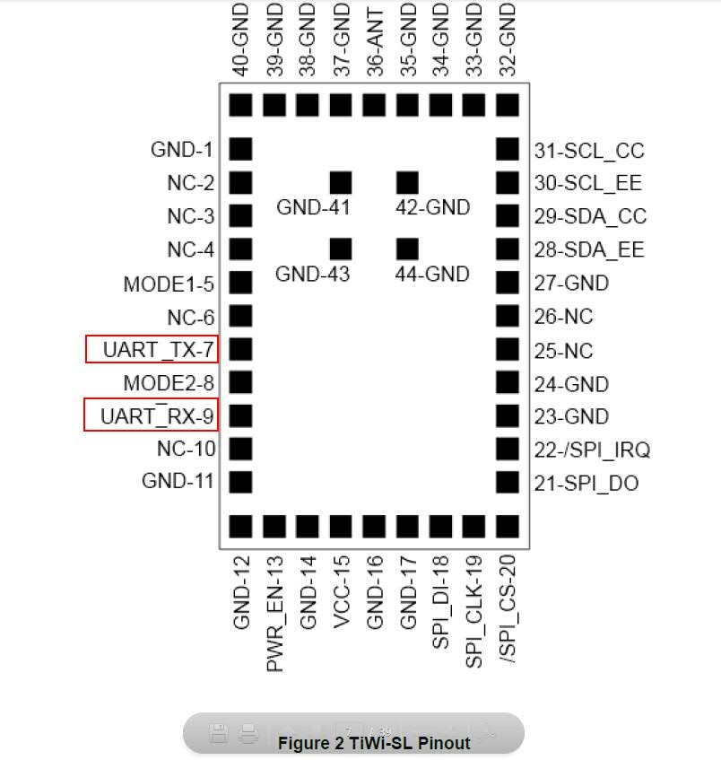

    Can you please go over this wiki page:
    http://processors.wiki.ti.com/index.php/CC3000_Logger
    Create the output file, and upload it here.
    I will try to figure out if there is any root cause in the log.

    Myself and Abhishek are working on same issue.
    With reference to your link, first step is:
    1.Identify the hardware pin for driver and firmware logger on CC3000 chipset
    - driver logger is tagged as NS_UART_DBG
    - firmware logger is tagged as WL_UART_DBG or UART_DBG
    What are these pins (NS_UART_DBG and WL_UART_DBG ) with respect to TiWi-SL chip?
    I have attached the Pin layout for TiWi-Sl and marked the UART pins that we have access to(Pin7 and Pin9).
    FYI, we are using custome board with non TI micro and using TiWi-SL module (also do not have any TI/LSR eval board).
    Please let us know, what what exactly needs to be done in our case?
  • Hi Yael,
    Please let us know the next step to get the log file.
    You need to use twe of the three (I'm not sure which is Driver, Firmware...)
    NC-2, NC-3, NC-4
    If you are using the LSR module, you can just follow this picture:
    Yael
  • Hi Yael,
    Thanks for Info.
    Yes, we are using LSR module. And as per LSR data sheet pin-out (ref my last reply in same post), mentioned pins 2, 3, and 4 are NC (not connected). So considering this fact we do not have any connection out for these PINs in our custom board (that has the TiWi-SL module soldered on it; Not same as you shown in the picture).
    Is this a new functionality provided on these pins and LSR is un-aware of this ?
    So at this point, we are unable to access these Pins. Please let us know what else we can try ?
    Once again thanks for your efforts so far.

    Also I created log file on 115200 bps
    Terminal log file
    Date: 21.03.2013 - 11:09:57
    wr 00300958 0001fffc
    wr 00306040 00000005
    wr 00306100 00000004
    wr 0031002c 02000020
    wr 003004dc ffffffff
    wr 00305450 00000000
    wr 00300998 0000ffff
    wr 00305618 00305618
    wr 00300824 00001c00
    wr 00300850 0000000.CG�^�fO�sF�F�b��F�GGF�'F�c�b�6FfG��F��G�6��G��g�F�vF���GF���FFJ�
