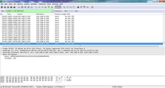

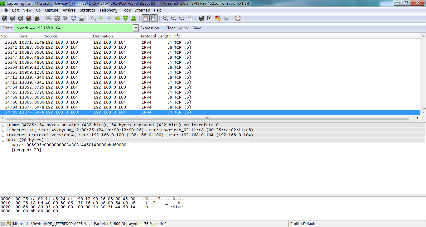

In my project, I need to use TCP protocol to send packet to server. I use  Basic Wi-Fi example code.
I can use UDP protocol  to send now, but TCP can not work.
In other post on e2e, someone have the same problem like me.
He told me if use wlan_connect() function, the problem will happened.
So I want to use wlan_add_profile() function to try.
I don't know if I use  wlan_add_profile() ,Should  I need to use SmartConfig to change policy by use  wlan_ioctl_set_connection_policy () function?
Could you give me step by step to do?
I try this code, but it is not work.Should  I need to use SmartConfig ? But I can not use first time config  now.
