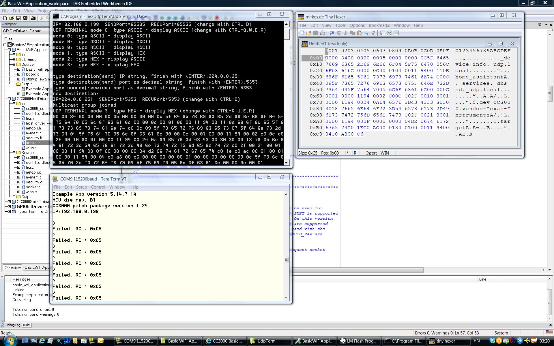

Hi All,
I've ported the basic Wi-Fi application to EK-TM4C123GXL (LaunchPad EVB). It seems working almost fine.
The device is able to join a WPA-2 secured network using SmartConfig procedure, the UDP data transfer works in both directions.
The only problem is related to mDNS advertisement. The CC3000 device transmits something but no mDNS listener can recognize the message (I did tried SmartConfig, ZeroConfig Browser and Bonjour Browser apps on Android and Java mDNS listeners for PC with the same result). With the debug purposes, I've captured the mDNS message by UDP terminal (the black window on the attached screenshot). For convenience, I've copied relevant part of the message to the hex editor window. It would be great if someone can tell what's wrong with that message.
Beside of that, it also seems strange the mdnsAdvertiser() call returns a non-zero value (see the Teraterm window on the screenshot). I suspect the value does not indicate an error. Rather it looks like the number of transmitted bytes because it depends on the length of the device name string (for "home_assistant" string the return value is 0xC5. Decreasing the string by one char results in the return value decreased by one and vice versa). Anyway I wonder if TI sometime would like to publish HCI error codes for the commands...
regards,
    Igor
  • Hi Igor,
    You are experiencing what many of us have been experiencing.
    If you want to see the history of this discussion go here - http://e2e.ti.com/support/low_power_rf/f/851/t/290584.aspx
    If you would like to see a potential workaround to the issue, check this discussion out - http://e2e.ti.com/support/low_power_rf/f/851/t/313896.aspx
    Glenn.
  • Hi Glenn,
    You're quite right. Actually there are many issues with mdns:
    1. The device does not respond to mDNS queries automatically. This problem is already discussed within the community and TI did clarified that they have no intention to improve the firmware in that regard.
    2. The device name is hardcoded to "target". This problem is also already discussed and TI did promised to address it in the next firmware release.
    3. During the Smart Config procedure execution, the TI-provided application (at least for Android) does not detect mDNS advertisement message from the device so the procedure finishes only on the timeout expiration. I presume this problem is specific to my particular case as I have found no discussions on that issue. So it seems the problem is caused by corrupted message sent by the device.
    4. The CC3000 host driver provides API  mdnsAdvertiser()  that allows applications to trigger mDNS ad message transmission. According to the manual, it returns zero on success. In my case it returns a non-zero value and the transmitted message is not recognized by listeners (even by that from TI). Something is definitely going wrong.

  • Hi Glenn,
    Thanks for the pointing. Unfortunately the chain does not cover a follow-up investigation. Anyway the conclusion is that the cause of the problem is still not clear. So the chances are it's not related to the CC3000 device itself. As such the root cause need to be found before proceeding with a workaround.
    With that purpose, I'd manually parsed the captured raw message (see the original post) and found no problems. There is no packet missing or corruption. The message seems syntactically correct and semantically meaningful (see the attached file). I'm not a mDNS guru, please correct me if it's wrong.
    Imo, the implication is no matter how  the message is generated (by the TI's firmware or by the user's app), the result will most likely be the same. It would not work here. It seems here is a factor external to CC3000 that prevents the things from working. And the factor may be different in each particular network setup.

  • Hi Igor,
    I wonder if you can actually capture what you are sending with some sort of mdns application, a few java ones exist if you google them.  I see you are using home_assistant as your name, but are you putting that into the app as the string to look for?
    I just dont see where you are going wrong, but I can say 0xc5 is expected for the size of your name, mine returns 0xc6 and you use one character less.  So it seems like the CC3000 liked the packet but whatever you are using is not for some reason.  Maybe try without the underscore?  Here is some info about my packet to look at:
    Using the smart config app:(notice the Device Name must match what is in you packet)

  • Hi Chad,
    In first, thanks a lot for confirming that mdnsAdvertiser() does not return zero on success. It turns out the comment in the header
    //@return On success, zero is returned, return SOC_ERROR if socket was not
    //! opened successfully, or if an error occurred.
    is just wrong and misleading. Seems it was blindly copy-pasted from somewhere.
    As for the device name, my screenshot does correspond to the name as it is in the TI-provided source. Of course I did tried different names to make sure changing the name does not make a difference. Also I did tried to increase the string length argument for mdnsAdvertiser to count the null terminator. Just wasted my time.
    Concerning the problem, I suspect something is wrong with my Android device (Samsung GT-P6810) running the SmartConfig app. I did tried two of them with the same result. But I did notice other applications using multicast are unable to work properly on that devices (Bonjour browser, PeerDeviceNet, etc.). Will try different device.
