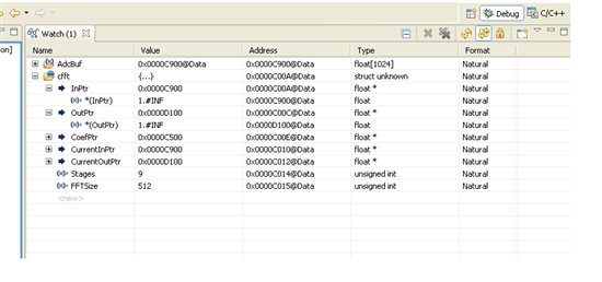

Hi all,
I'm doing a project that use FFT and IFFT.
First I try with the example from FPU library ("2833x_RFFT_ADC_RT") and the result is very good. But after that I tranfer the Rfft_f32u function to Cfft_f32u,the FFT can't work properly.
Please help me solve this problem!
I attached the result from Watch wimdow:
This is the code of my program:

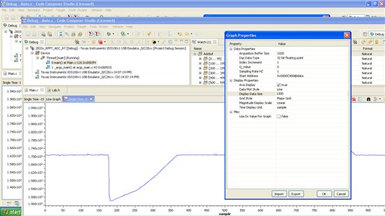

BTW, I have another question about  "Graph" in CCS4.0. That is I can't make the data from ADC running online but just show the result at one time.
Hoang Cuong.
  • Dear all,
    I also try with a constant array for the input of CFFT and it still can't work. Look like that the CFFT can't work when we have an interrupt in the program?
    How can I fix this problem?
    Hoang Cuong.

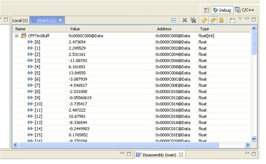

  • Dear Yu Cai,
    To clear about the result, I post in here some more picture about the CFFT before and after I put the CFFT to while loop.
    The result from the example code provided by TI:
    And after I put the CFFT into While loop, the result become:
    In the Picture 4, we can see the value of Input buffer has changed by the effect of CFFT.
    Could anyone tell me why?
    Hoang Cuong.
  • To save memory, the FFT is done by ping-pong buffer. so ur expectation that input buffer doesn't change wouldn't happen.
