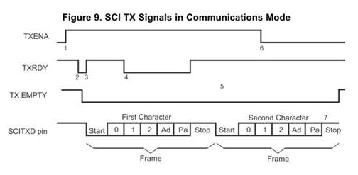

 I have confused about TXEMPTY of SCI for the TMS320F28035.
         The flag defined as below:
The figure refers to TMS320x2802x, 2803x Piccolo Serial Communications Interface (SCI).
The figure can observe this flag set high after the stop bit.
But the results are not the same with our’s experiment result.
The experiment use 38400 baud rate, so the frame length is 1/38400*10.
Ch2: Singnal pull low represent TXEMPTY flag set high
Ch3: TX signal
But the flag set high before the stop bit. Please let me know if have any answer, thanks.
