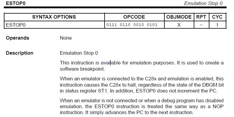

    watch: row No.956 at 0x3F624F was compiled as ESTOP0?
     this is after one successful compile with no mistakes, I only found the proble when it stops here.
    what happened?8117.wrong_compiled.pdf
  • Harrison,
    ESTOP0 is emulation stop 0. Executing ESTOP0 shouldn't trigger Illegal ISR. Please find description of ESTOP0 attached below.
    Manoj

    I knew ESTOP is the insrtuction, my point is I didn't have this instruction in my code and I didn't add this breakpoint either.
     the code is mytimer = 0, which should not be compiled into ESTOP.
    in another word, the compliler made a mistake.

  • 4530.Fdisassembly2.pdf
    Manoj Santha Mohan said:
    Harrison,
    Manoj
    Hi Manoj,
    please have a look at the attached, the same code, but it was compiled correctly this time.
    mytimer1= 0 was compiled to MOV @0x3b,#0
  • Okay, now I understand. How did you get this fixed? Did it solve your problem.
