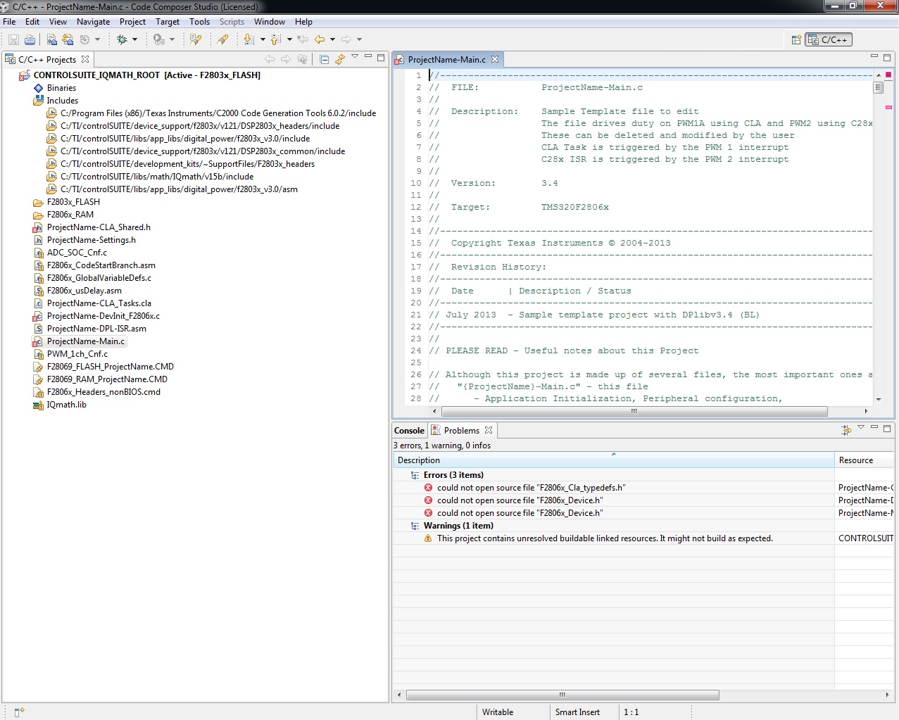

I'm trying to use the Digital Power library with CLA on F2806x device. Since, there are no Digital Power template projects defined specifically for F2806x I'm modifying one of DSP2803x template projects as mentioned in the System Framework Overview in the Templates Folder.
I modified all the include and link files, however, when I Build the code I get the error that could not open  F2806x_Cla_typedefs.h
I know that F2806x v136 supports "F2806x_Cla_typedefs.h" file but I cannot use it with F2806x v100 headers file -- they are incompatible.
Is there any provision to get away with this error.
Sincerely,
Jaspreet

  • Hi Brett,
    Thanks for your quick reply.
    As you mentioned, I tried using the v136. I get another set of errors saying EPwm1Regs, EPwm2Regs, EPwm3Regs, EPwm4Regs, EPwm5Regs, EPwm6Regs... are undefined in resource: DPLib.h. and a warning: typedef name has already been declared (with same type) in resource: F2806x_Cla.typedefs.h
    The EPwmxRegs are defined in the DPLib.h library for indirect access to all EPWM modules.
    No idea why the compiler is complaining about this. Probably, I don't understand the use of EPwms to be used as indirectly. However, this won't effect the typedefs.h.
    Sincerely,
    Jaspreet

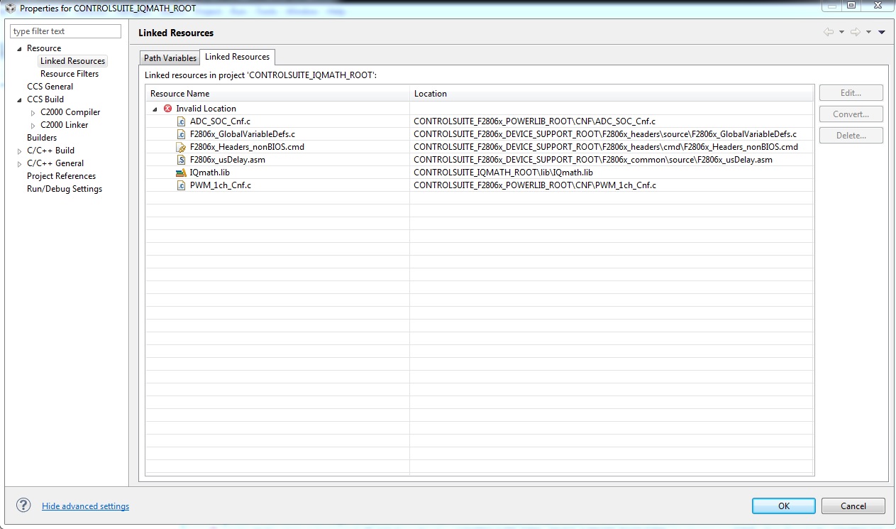

  • Brett,
    Thank you for sending across Template project for DPLib F2806x family. I'm working on it at the moment, however, still getting errors
    unresolved symbol mdebugstop
    unresolved symbol cla_scratchpad_start
    unresolved symbol cla_scratchpad_end
    Thank you
    Jaspreet

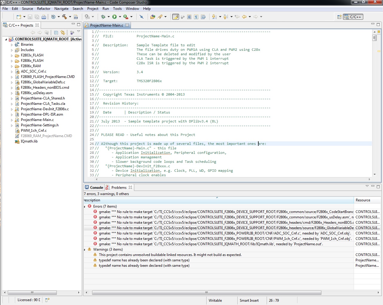

  • Igor,
    Thank you for the reply. The error disappeared. However, I'm receiving an error saying that _ClafuncsRunStart expression is used before it has been assigned a value. Quite difficult to figure out why compiler is complaining about it.
    For your reference the contents of linker file are as follows:

  • Hello Igor,
    I tried the first option, problem still persists.
    The second option directs me a 404- File not found page. Can you please mention the link again please.
    Sincerely,
    Jaspreet

  • Hello Brett,
    I unzipped both the files as mentioned in the readme.txt. I had to modify the code little bit to include the F2806x headers and common files using the Build options. However, I receive
    Error: could not open the source file PWMDRV_CLA_C.h
    Warning: 1) This project contains unresolved buildable linked resource. It might not build as expected. 2) typedef name has already been declared (with same type).
    It sounds that both assembly and C coding of CLA has been mentioned in the project. I believe I need to include or exclude some of the files to use the Project for the CLA C code.
    Also, I would like to mention from my previous comments in this thread that I'm using RAM as my active build configuration so I might have to exclude the FLASH.cmd files. Please correct me if I'm wrong.
    On top of this, I'm constantly getting error message for unresolved symbol mdebugstop, unresolved symbol cla_scratchpad_start, unresolved symbol cla_scratchpad_end, and symbol "_Cla1funcsRunStart" used in expression before it has been assigned a value.
    For your reference, these are the options I select in the complier:
    --silicon_version=28 -g --define="_DEBUG" --define="LARGE_MODEL"
    --include_path="C:/Program Files (x86)/Texas Instruments/ccsv4/tools/compiler/c2000/include"
    --include_path="C:/TI/controlSUITE/device_support/f2806x/v136/F2806x_headers/include"
    --include_path="C:/TI/controlSUITE/device_support/f2806x/v136/F2806x_common/include"
    --include_path="C:/TI/controlSUITE/development_kits/~SupportFiles"
    --include_path="C:/TI/controlSUITE/libs/math/IQmath/v15b/include"
    --include_path="C:/TI/controlSUITE/libs/app_libs/digital_power/f2806x_v3.4/asm_macros"
     --include_path="C:/TI/controlSUITE/libs/app_libs/digital_power/f2806x_v3.4/include"
    --diag_warning=225 --large_memory_model --cla_support=cla0
    Please let me know if you would need more details about the template project I have configured on my system.
    Sincerely,
    Jaspreet
  • Jaspreet,
    Why did you have to 'modify the code a little bit to include the F2806x headers and common files using the Build options'?
    I think everything should work directly.

  • Hello Brett,
    The reason I modified the code because the compiler was giving error:
    Could not find F2806x_Device.h and other header files which assume the project is built for 2803x device.
    Sincerely
    Jaspreet

  • Hi Brett,
    I did as you mentioned above.
    This is how the Project structure look like with errors. Also, I want to mention that I'm using CCSv4 not v5.
    Sincerely,
    Jaspreet
  • Jaspreet,
    That is the issue then.  I built the template project with CCSv5.  CCSv4 projects can be imported into CCSv5, but CCSv5 projects are not importable into CCSv4.
    Is using CCSv5 a possibility for your project?
    Thank you,
    Brett

  • Hello Brett,
    I have installed the CCSv5. The complier is showing these errors.
    I believe these files are linked to the project as defined in the Project Properties/Resource/Linked Resources. However, I want to mention that red cross is displayed saying Invalid location as below.
    Can you please look why this is so. Do I have to link the files again?
    Sincerely,
    Jaspreet
  • Hello Jaspreet!
    You do something wrong. I use CCSv5.2. I have downloaded ZIP of Brett and I have done all the instructions in the file Readme. Then I have done "Import existing CCS eclipse project" with filled check box "Copy projects into workspace". Then I got warning about compiler version (project was builded with 6.1.4, but my CCS uses 6.1.0). I have corrected compiler version at Project's Properties. It was all. Then the project was builded successfuly.
    Good luck,
    Igor
  • Hello Brett and Igor,
    I just discovered that since I have both CCSv4 and CCSv5 in my system, the default location for controlSuite folder is set for CCSv4. I have now changed it for CCSv5.
    This give me no error but two warnings which Brett mentioned on the typedef.
    Sincerely,
    Jaspreet
