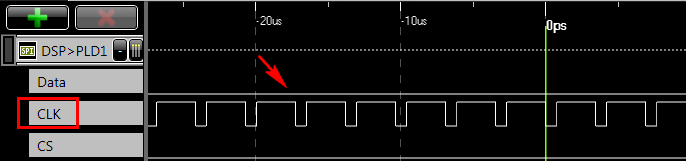

I change periodically SPI configuration
(see Question )
I notice that when I change SPI configuration
CLK signal execute spurious negative pulse as you see in the image.
my code is
