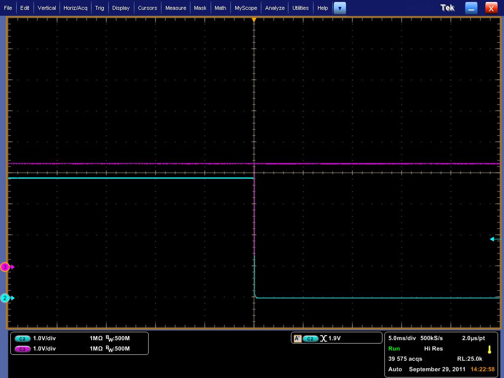

  • Hello Vishal, by now u must have guessed my programming ability...
    Anyways...
    As soon as my programs steps through the start bit (like earlier before), the clock goes low. Attached is the screen capture.
    I just changed the IRS bit to 1 as mentioned, no other changes..
  • Hello Vishal,
    After further digging in, i figured, even after setting the I2CMDR = 0x6E20, while stepping in to the code, it does not write it to the register... BB bit is set
    with I2CSTR = 0x1406. I dont know, how it is being set.???
    After using the Step into function, i realized, once the code reaches the line to enable the STT bit, it does not get updated in the MDR register and it takes the clock line low with it.
    Even if i set the MDR register as 0x6E20, it gets set as 0x4E20.

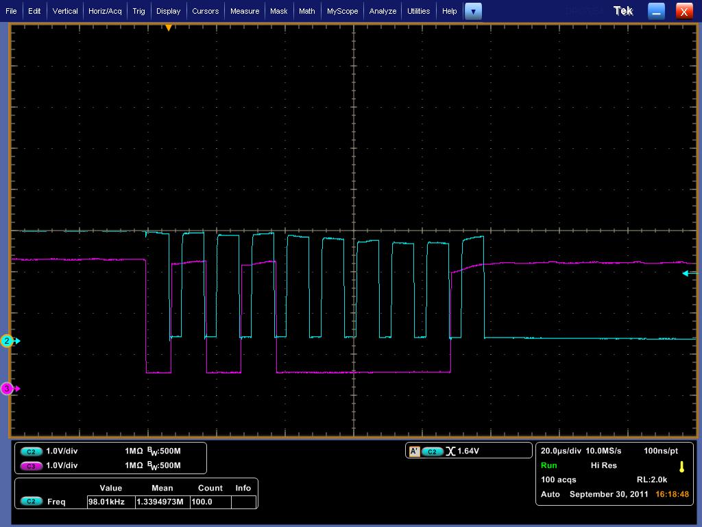

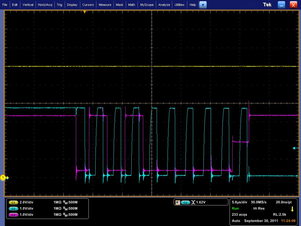

  • Ok,
    Here is another screen capture.... I can see only the Address being sent, and then the clock goes low..
  • If you see the sequence you have (Start bit)S. (Address)1 0 1 0 0 0 0. 0(W).1(NACK...the value is neither gnd nor VCC its somewhere in the middle). It looks like your EEPROM is not acknowledging the address on the line. What EEPROM are you using?
  • I am using a ST M24C02.
  • Id suggest checking that the external pins E0->E2 on the EEPROM are properly grounded. other than that you could try transmitting at a lower speed @ 100k and see if that makes a difference. you can set CPSC to 5, CLKH to 30 and CLKL to 60.
  • Hello Vishal,
    I tried using a lower clock speed of 100Khz... it still gives the same above waveforms.
    I tried using a lower pullup value of 2.2K instead of 3.3k. It still takes the clock low.
    I checked my address lines and they are properly grounded. I have hardware lines connecting to the ground. It seems something is not right with the piccolo device itself. I was planning to use the device in further applications..

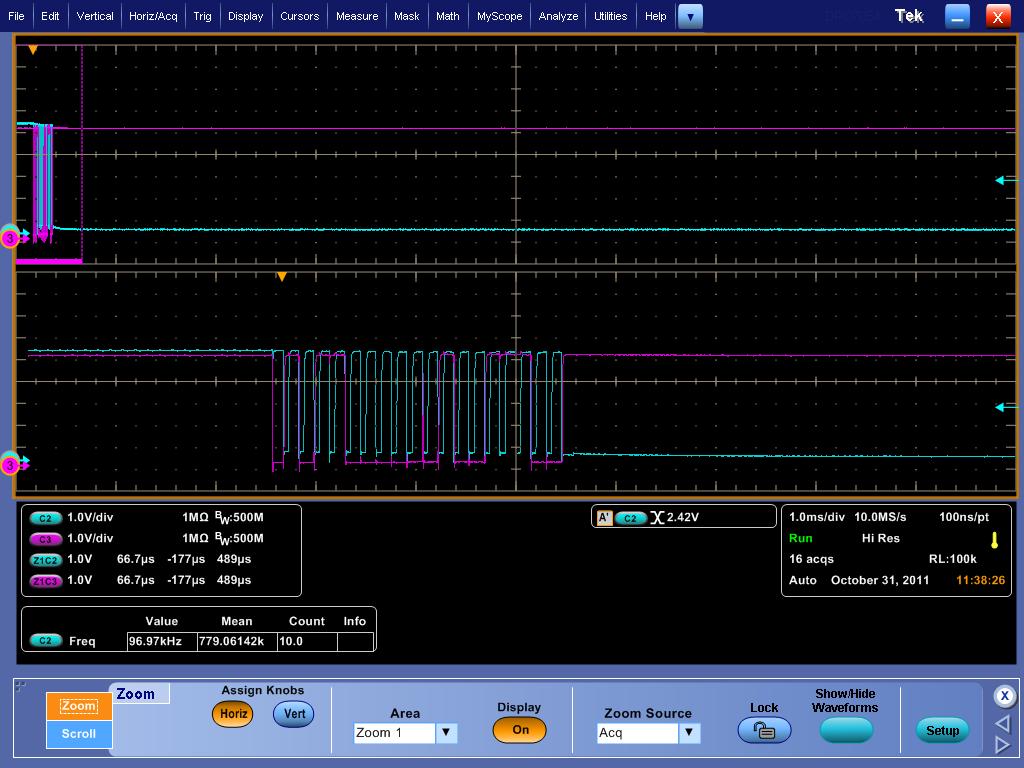

    Do you think, its the hardware causing the problems of the i2c lines?
    One more important thing, when i do not connect the EEPROM at all, this is the waveform i get.
  • Hello Vishal,
    Finally the Clock line pulling low problem has been solved.
    Thankfully i have the local TI support, who solved the problem. It was found on a particular pin 28(SDA).
    After using a different SDA pin 32, it works like a charm.

    Initially, i was not polling the XRDY bit.
    In that case, instead of sending my 2 bytes (since count =2) address and checksum, it was just sending checkum. Attached is the scope capture.
    Cant i just write to the DXR register as follows
    I2caRegs.I2CDXR = addr_mcu[j];
    I2caRegs.I2CDXR = chk_sum[j];
    If yes, how can i check to see if content in DXR is shifted before i am filling it with 2nd byte (checksum in this case).
    From the scope capture, i can see my ACk from the EEPROM, and my 2nd byte (checksum). But, the register address (0x02 in this case) , i think is overwritten in the DXR.
  • If you want to write successive bytes to I2CDXR you need to be in FIFO mode while transmitting. If not you will have to poll XRDY each time to figure out when to write the next byte to DXR
  • Ok,
    Now it works. i am not using FIFO at this time, but something to consider.
    I just changed my checksum byte to write to DXR after the MDR register as you suggested.
    I appreciate your help.
