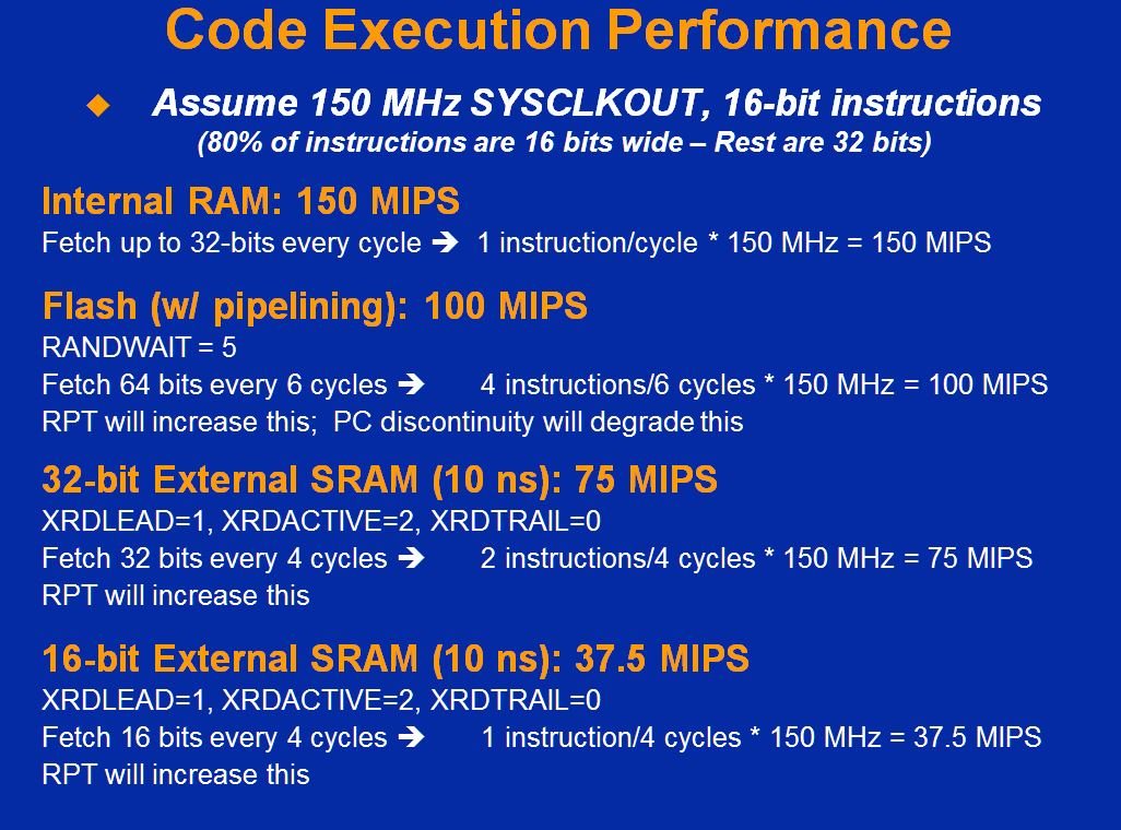

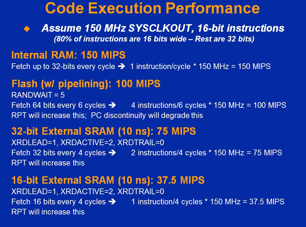

    Ignoring for a moment the issue you are having running from external RAM, I'd like to ask you what you hope to achieve by copying your code over to external RAM.  You had said:
    "In order to shorten running time of the program, I want to load .text and .econst section of program from flash to external RAM in XINTF Zone 6"
    Running the code from external RAM is going to be slower than internal flash.  Are you aware of this?
    David

  • QuanXing,
    >> 1.Please help me make sure whether the configuration of inner Flash is the best
    The configuration you are showing is correct for 150 MHz.
    >> 2.I use 6.67ns 32-bit External SRAM, How to configure the speed of external SRAM is to 150MIPS?
    A 6.67 ns SRAM is very fast, but in fact it will perform no better with F28335 DSP than a 10 ns SRAM.  You can run the numbers in section 5.9.6 of the datasheet SPRS439n.  For example, the read timings:
    With X2TIMING=0 ==> tc(XTIM)=6.67 ns.
    For XRDLEAD=1, XRDACTIVE=2, XRDTRAIL=0 ==>
      LR = 6.67 ns, AR = 20 ns, TR = 0 ns.
      ta(A) = LR + AR - 16 = 10.67 ns.  This will work with a 10 or 6.67 ns SRAM.
    If you make XRDACTIVE=1, similarly with above you end up with ta(A) = 4 ns.  This won't work with a 6.67 ns SRAM.
    So, you need XRDLEAD=1, XRDACIVE=2, XRDTRAIL=0.
    >> 3. Because my hardware already use DSP28335,my program mainly do matrix compute. Because my program is big, but the inner SRAM is so small, I must use external SRAM (for example .bss and .ebss section), I want to shorten running time of the program, how to shorten the time of matrix compute.
    Are you saying that your key algorithms for matrix compute are too large to fit into internal memory?  I don't mean your entire program.  I mean just the matrix compute routines.  I would think these should fit into internal memory, and could be put there using the technique shown in appnote SPRA958.

    In your case, you've got InitExtMemIf() as part of the .text section, and you've located .text in external RAM.  In the sequence above, you are trying to run InitExtMemIf() before you've copied stuff to external RAM.  You cannot do this.  I would locate InitExtMemIf() in a different section, say .text2 (or whatever you want to call the section).  Just leave this section alone in flash.  Then, the above sequence should work.
    But I think you have something else wrong in your code as it doesn't run correctly.  I do not know what.  You will have to debug it with a combination of stepping and hardware breakpoints.
    I still wonder what you are trying to achieve here.  Running your code from external RAM is not going to be faster than the internal flash.
    David
  • David:
    As your said, I only load the main matrix compute function from flash to internal memory using the technique shown in appnote SPRA958,
    But the compute time can't be shortened. Can you give me other adivice to shorten the compute time
    scqxlxc
    Check to make sure the matrix functions are not in the same RAM block with the matrix data itself.  I doubt they are, but check.  If they are in the same RAM block, move one of them to a different RAM block.
    After that, all you can do is try to hand optimize the matrix function(s) using hand assembly code.
    David
