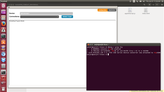

  • Hello
    Firstly, thanks for reply
    I want to let you know that I was following instructions from the videos on this link
    http://www.ti.com/tool/INSTASPINFOCMOTORWAREGUI
    Now,
    1) I'm able to run GUI Composer Runtime Installation and Webapp for Universal InstaSPIN-FOC GUI on UBUNTU 13.10
    But now it is not moving forward from:
    Restarting Program Model...
    and the terminal is showing that FTDI USB Serial Device converter is attached

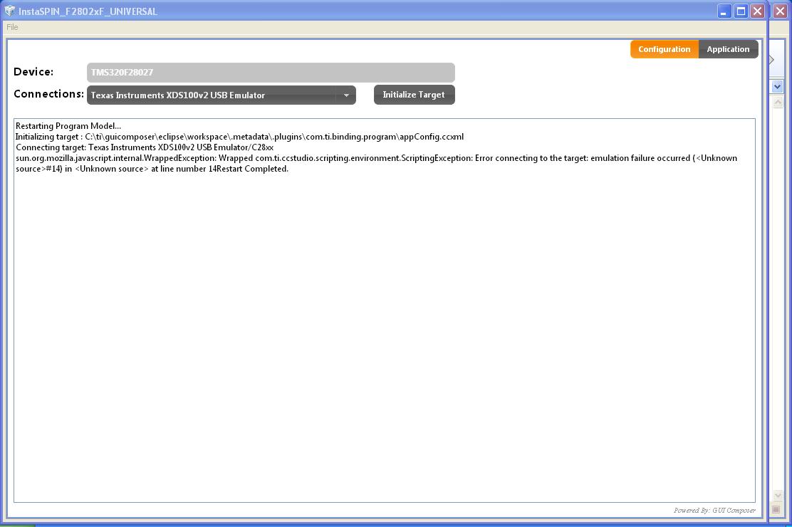

    2) So, I tried it on win XP and again there was an error msg which I am not able to correct
    please tell me how to correct it.

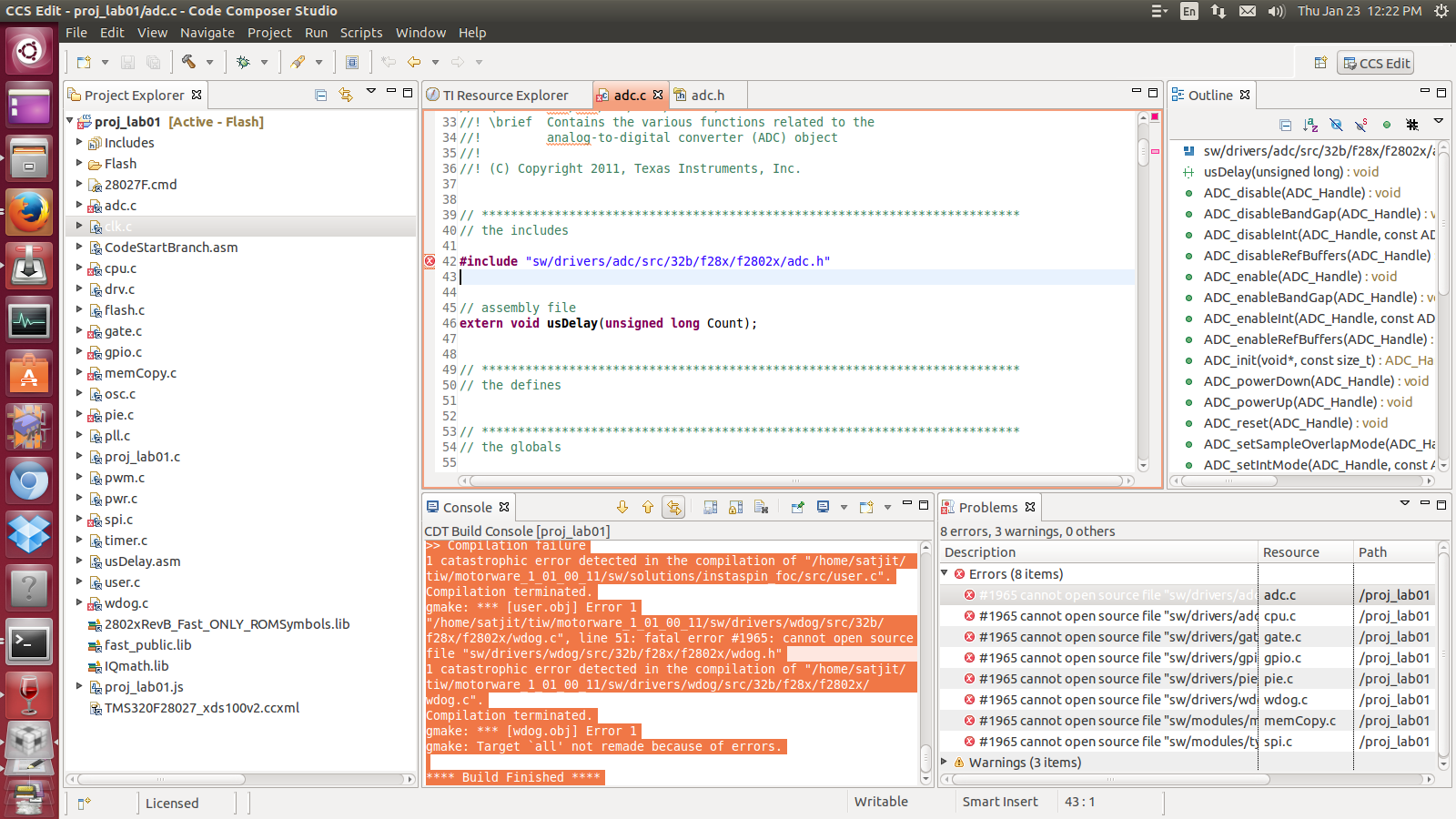

    3) And, as you have told me to try
    C:\ti\motorware\motorware_1_01_00_11\docs\labs\instaspin_labs.pdf
    so I tried BUT again I got unexpected errors during build process
    **** Build of configuration Flash for project proj_lab01 ****
    /opt/ti/ccsv5/utils/bin/gmake -k all
    Building file: /home/satjit/tiw/motorware_1_01_00_11/sw/drivers/adc/src/32b/f28x/f2802x/adc.c
    Invoking: C2000 Compiler
    "/opt/ti/ccsv5/tools/compiler/c2000_6.2.0/bin/cl2000" -v28 -ml -mt -O2 --include_path="/home/satjit/tiw/motorware_1_01_00_11/sw/solutions/instaspin_foc/boards/boostxldrv8301_revB/f28x/f2802xF/projects/ccs5/proj_lab01\..\..\..\..\..\..\..\..\..\../sw/drivers/drv/boards/boostxldrv8301_revB/f28x/f2802x/src/" --include_path="/opt/ti/ccsv5/tools/compiler/c2000_6.2.0/include" --include_path="/home/satjit/tiw/motorware_1_01_00_11/sw/solutions/instaspin_foc/boards/boostxldrv8301_revB/f28x/f2802xF/src" --include_path="/home/satjit/tiw/motorware_1_01_00_11/sw/solutions/instaspin_foc/boards/boostxldrv8301_revB/f28x/f2802xF/projects/ccs5/proj_lab01\..\..\..\..\..\..\..\..\..\.." -g --define=FLASH --diag_warning=225 --display_error_number --asm_listing --preproc_with_compile --preproc_dependency="adc.pp"  "/home/satjit/tiw/motorware_1_01_00_11/sw/drivers/adc/src/32b/f28x/f2802x/adc.c"
    "/home/satjit/tiw/motorware_1_01_00_11/sw/drivers/adc/src/32b/f28x/f2802x/adc.c", line 42: fatal error #1965: cannot open source file "sw/drivers/adc/src/32b/f28x/f2802x/adc.h"
    1 catastrophic error detected in the compilation of "/home/satjit/tiw/motorware_1_01_00_11/sw/drivers/adc/src/32b/f28x/f2802x/adc.c".
    Compilation terminated.
    >> Compilation failure
    gmake: *** [adc.obj] Error 1
    "/home/satjit/tiw/motorware_1_01_00_11/sw/drivers/clk/src/32b/f28x/f2802x/clk.c", line 50: fatal error #1965: cannot open source file "sw/drivers/clk/src/32b/f28x/f2802x/clk.h"
    1 catastrophic error detected in the compilation of "/home/satjit/tiw/motorware_1_01_00_11/sw/drivers/clk/src/32b/f28x/f2802x/clk.c".
    gmake: *** [clk.obj] Error 1

    >> Compilation failure
    1 catastrophic error detected in the compilation of "/home/satjit/tiw/motorware_1_01_00_11/sw/solutions/instaspin_foc/src/user.c".
    gmake: *** [user.obj] Error 1
    "/home/satjit/tiw/motorware_1_01_00_11/sw/drivers/wdog/src/32b/f28x/f2802x/wdog.c", line 51: fatal error #1965: cannot open source file "sw/drivers/wdog/src/32b/f28x/f2802x/wdog.h"
    1 catastrophic error detected in the compilation of "/home/satjit/tiw/motorware_1_01_00_11/sw/drivers/wdog/src/32b/f28x/f2802x/wdog.c".
    gmake: *** [wdog.obj] Error 1
    gmake: Target `all' not remade because of errors.
    **** Build Finished ****
    but as u can see in the scree-short adc.h is open in CCS in the same project??????????????????????????/
  • 1. It doesn't appear that the GUI Composer exe works with Linux.  You would have to ask on the CCS Forum. I think support may be added in the next version.
    2. The error states that it it's not connecting to the emulation target.  This means a) the emulator/controlCARD isn't powered or the USB cable isn't plugged in b) the driver isn't installed (it should install with CCS at a minumum)
    3. I think there are two issues.
    a) There is a huge WARNING post at the top of this forum regarding Compiler 6.2.x; please read the post and follow the instructions: http://e2e.ti.com/support/microcontrollers/c2000/f/902/t/295599.aspx
    b) I don't think you have the paths correct. It concerns me when I see things like
    "proj_lab01\..\..\..\..\..\..\..\..\..\../sw/drivers"  that your project isn't resolving locations correctly
    Right Click on a project --> properties --> Resources --> Linke Resources
    check the path variables and the linked resources to make sure thngs are resolving
    Also, it's POSSIBLE that the overall path directory in windows became too long.  I notice that you installed MotorWare
    a) at ="/home/satjit/tiw
    b) without a leading /motorware/ folder
    we recommend installing directly at
    DRIVE: ti\motorware\motoreware_1_00_01_11
