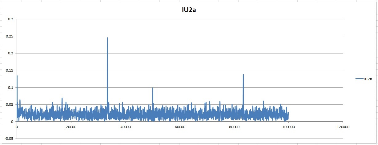

I've setup code to trigger the 16 channel ADC cascade sequence off a timer interrupt at 5us intervals (i.e. sampling @ 200kHz), and the ADC ISR stores each of the results in external SRAM. The code takes 16384 samples from each channel, and then I perform a memory dump, load the data into Excel, and perform a 4096 point FFT on the first quarter of the samples and check the bitspread (minimum to maximum spike values).
I have tried changing a few things, including the ADC clock frequency and aqusition window, the sample rate (200kHz, 333kHz and 500kHz), the ADC channel sequencing (both channel count and channel order).
Results:
I'm getting (generally) 20-30 bits of error (min to max spike) on all channels, except for 15 and 16 because these channels grounded so we only see half the range.
Here are some representative images showing typical bit spread on all channels, and the plot from one the first channel (IU1):
Here is the FFT associated with the first 4096 bits of the first channel (x-axis is Hz, y-axis is bits):
The above FFT used samples taken at 200kHz, with ACQ_PS = 0 and ADCCLKPS = 0 (ADC Clock = 25MHz, ADC Sample and Hold Time = 1/25MHz = 40ns). A nice, clean spike is seen at 66.6667kHz.
Below I tried changing the halving the ADC Clock frequency (i.e. ADCCLKPS = 1, ADC Clock = 12.5MHz, ADC Sample and Hold Time = 1/12.5MHz = 80ns) and the noise is now dispersed throughout the spectrum, with a major spikes at 33.333kHz, 83.333kHz and 50kHz:
Next I changed the ADC clock back to 25MHz, but tried sampling with a timer @ 6us (166.66kHz), and the noise spike shifted to 55.556kHz:
Can anyone suggest why I'm seeing different noise profiles depending on setup?
Could the noise be caused by the DSP/ADC, or be an artifact of the FFT process? Could the noise be a much higher frequency signal and my sampling rate is causing aliasing?
Does anyone have any information that would be helpful, or suggestings for further testing?

  • For anyone wondering, we've managed to find the culprit of the noise: a charge-pump capacitor from an RS-232 chip was located near the DSP.
