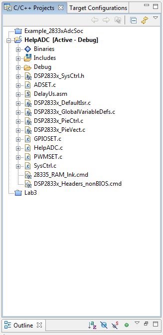

  • Hi Ananda,
    I propose you to use a GRAPH to see the result of your ADconversion.
    First of all:
    I'm using the Code Composer Studio 4 version Microcontroller, you can make download gratuit
    http://processors.wiki.ti.com/index.php/Code_Composer_Studio_v4
    Let's begin:
    1) New-Project and configure your  project to use the Delfino Microcontroller 32bits
    2) Go to: Project->Properties->C/C++ Build->Include Options and add the directories DSP2833x_headers\include
    and the DSP2833x_common\include.
    3) In the IDE CCS4 at left side you will find the C/C++ Projects, make a right click in your project ->New->file
    choose for name: HelpADC.c or something like that (or not :P).
    4)make a right click in your project -> link files to project, find and link the files:
    DSP2833x_DefaultIsr.c, DSP2833x_PieCtrl.c, DSP2833x_PieVect.c,  DSP2833x_GlobalVariableDefs.c,
    28335_RAM_Ink.cmd, DSP2833x_Headers_nonBIOS.cmd, DSP2833x_SysCtrl.h
    5) Write on the HelpADC.c file:

  • Dear Vanderley Maia,
    we made your program but it is not building why please give reply, i given cc4 figure also.
    Normal 0 false false false EN-US X-NONE X-NONE MicrosoftInternetExplorer4
    One more help ,
    How to work on DMA with ADC,
    AAK
  • Hi Ananda,
    Well I didn't get why isn't building?
    You made your Target Configuration?
    Here My Project:
    Take my project in: http://www.4shared.com/file/96uMTYEL/HelpADC.html
    About DMA with ADC, I have no experience but I will read about and if I understand
    I will reply you.
    Best regards!
