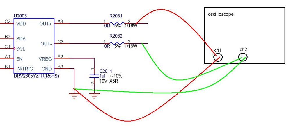

Can the Drv2605 output voltage be adjuested ?
Other Parts Discussed in Thread: DRV2605, DRV2605EVM-CT
Drv 2605 VDD: 5V
Drv 2605 mode: External Trigger / RTP mode
Vibrator rated voltage  : 3V
Vibrator operating voltage : 2.0 ~ 3.6V

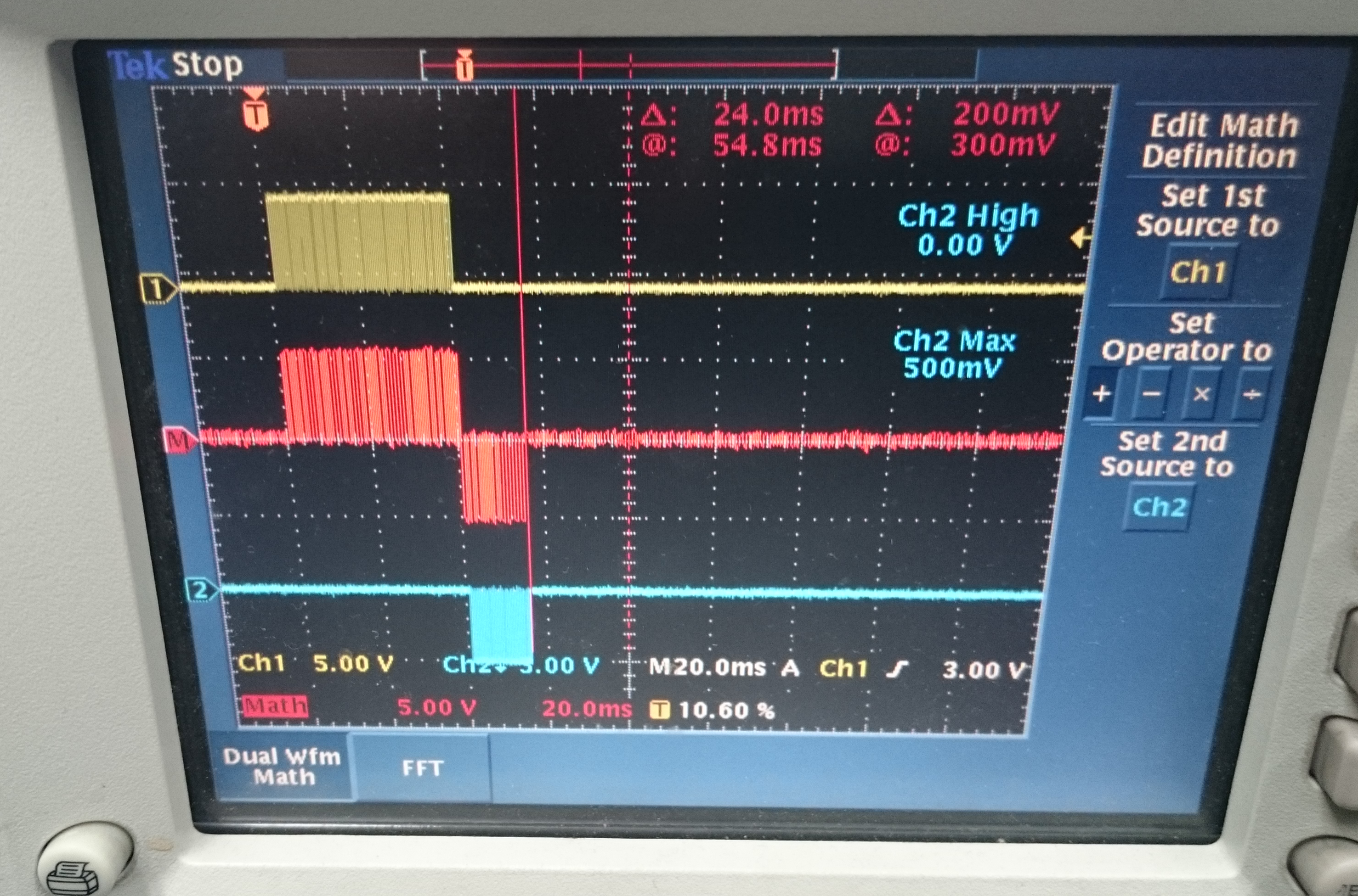

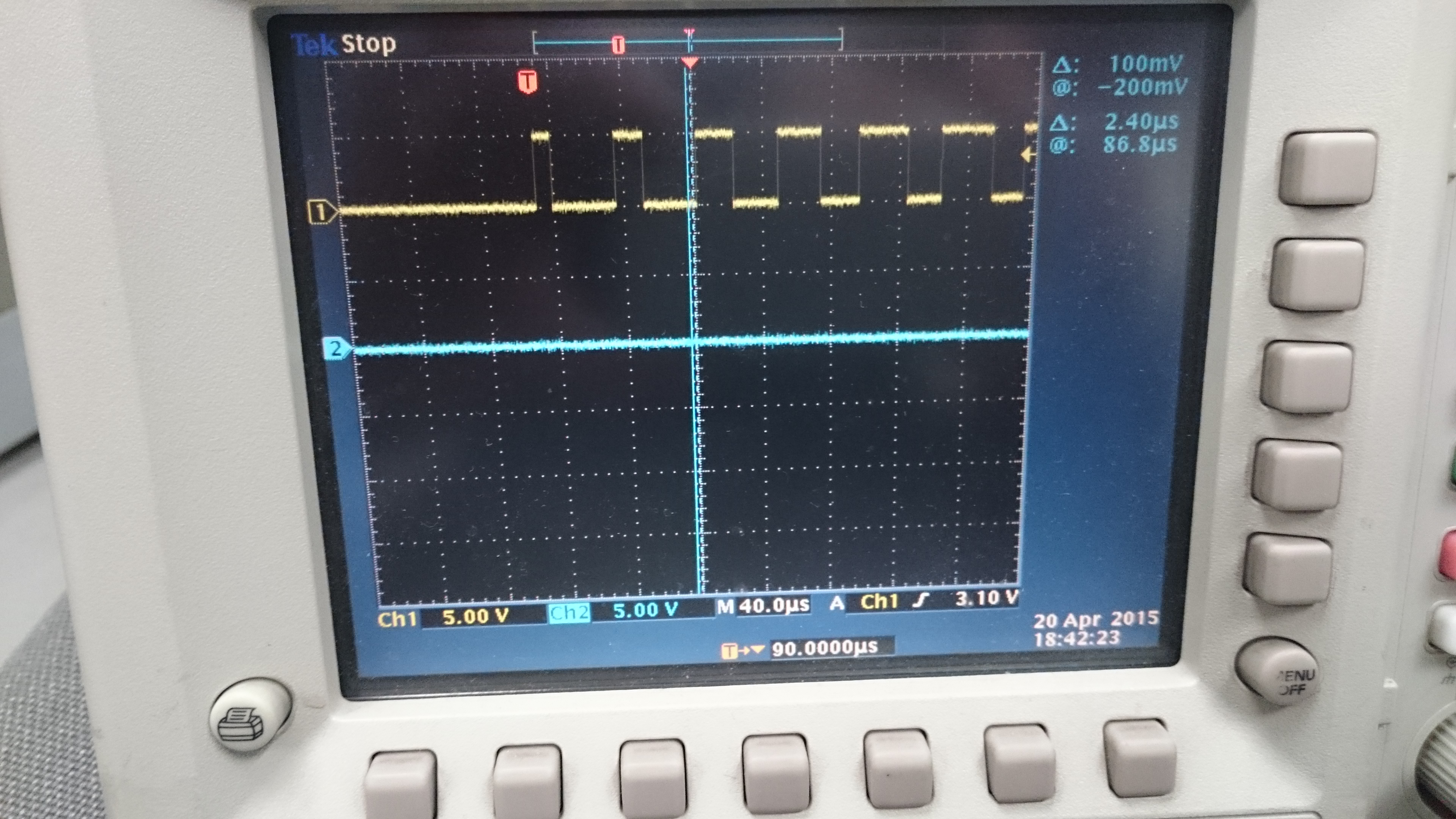

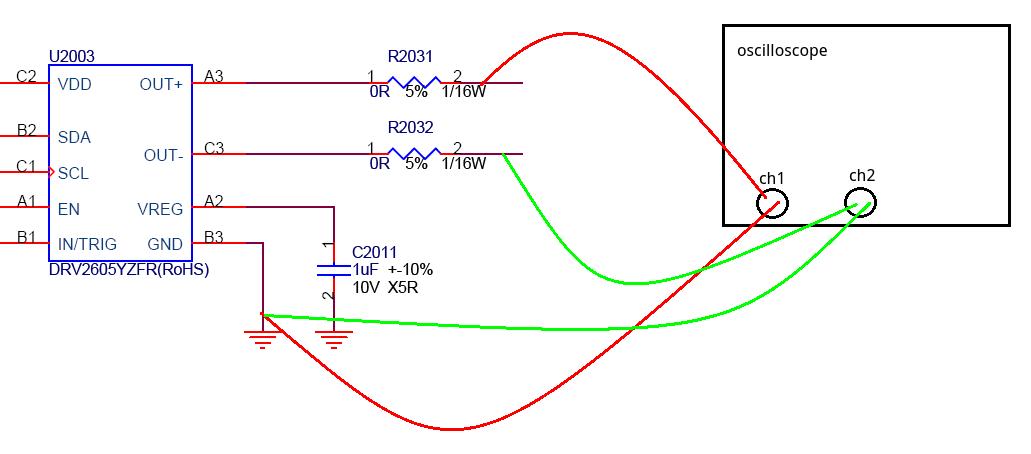

Measure status:  Use the oscilloscope to measure OUT+ and OUT- .
One channel connect  OUT+ and ground
the other connect  OUT- and ground

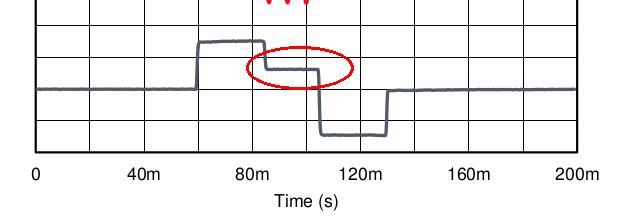

Question: Can the Drv2605 output voltage be adjuested ?
I set Rated Voltage (Address: 0x16) -> 0x8F & Overdrive Clamp Voltage (Address: 0x17) -> 0xA4.
But the output still 5V.
