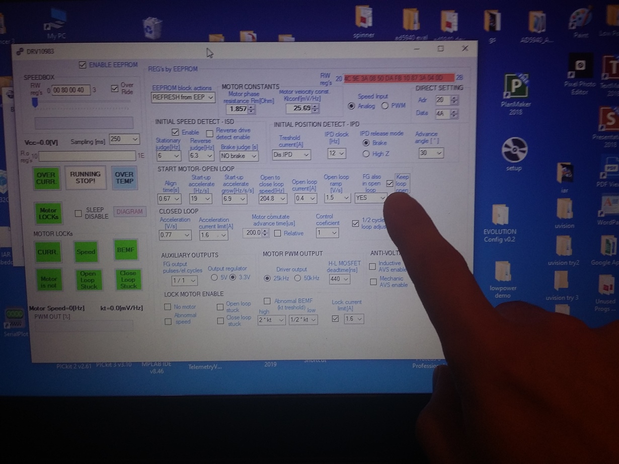

I attach a picture from my 32 Bit low pas filtered frequency speed measurement in open loop and closed loop modes.its amazing the speed drift or speed hunt is massively improved by changing the controller from closed loop mode to open loop mode see pictures attached
My question is can it be improved by tuning closed loop mode to be even better than open loop mode.Is there a parameter that alters the PI speed algorithm update rate so speed hunts less in closed loop mode
By changing to open loop mode the speed hunt is far less but there is still quite a bit of movement even in open loop which the senior designer is not happy with.
In closed loop I followed the DRV10983 tuning guide and I have tried so many changes the best stability i can get is 0.1Hz +/- in 200Hz

Pictures attached 3000RPM open Loop Closed Loop and also My DRV10983 settings only difference in two graphs is open loop ticked or not ticked.

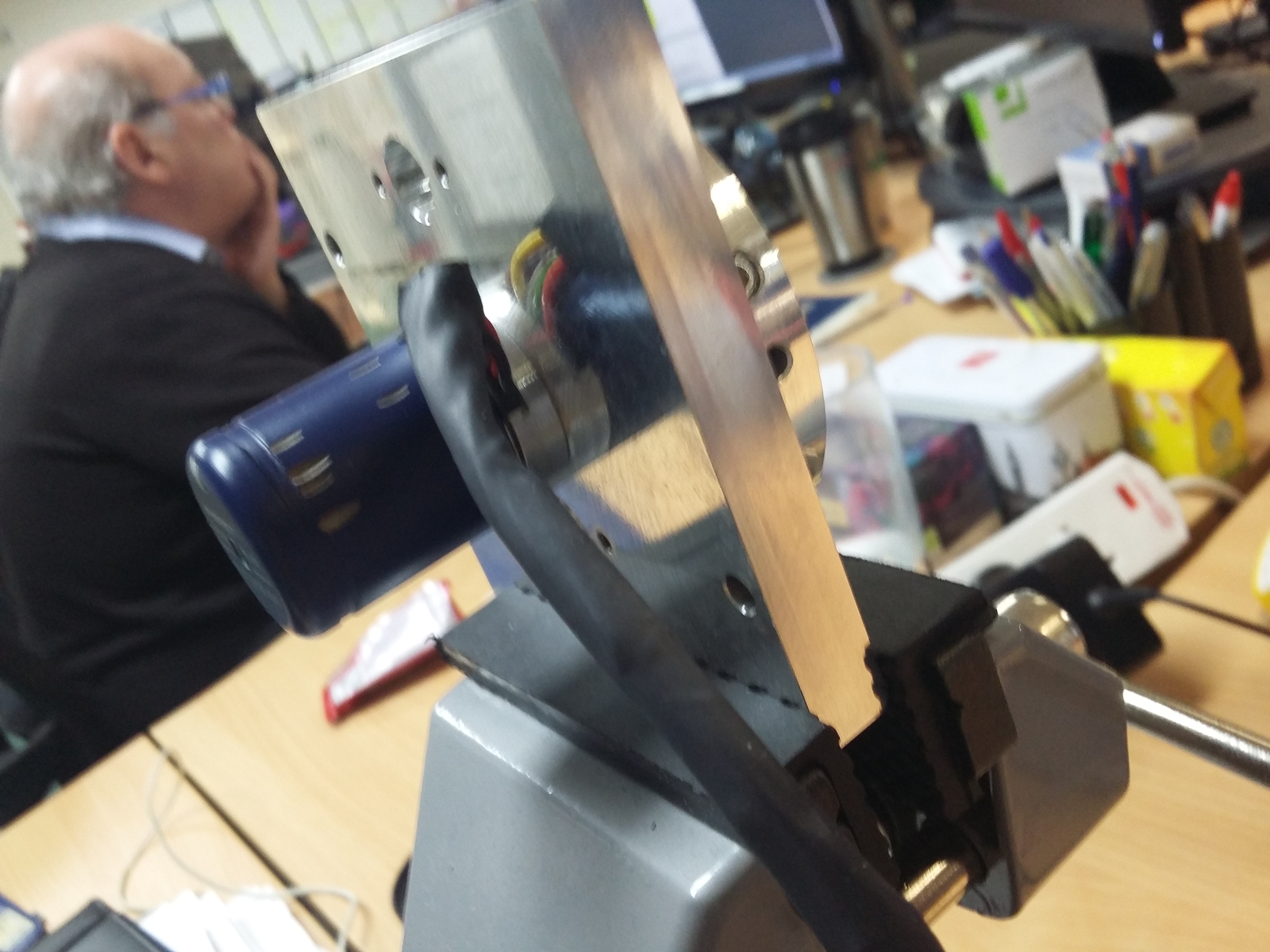

  • Here is a picture of the motor and the setup,
    The Rm pase to phase / 2 = 1.857 R    :::         The KT is calculated using scope to give 25.69mv/hZ
    The motors rated to 5000 RPM we use it at 3000 Rpm

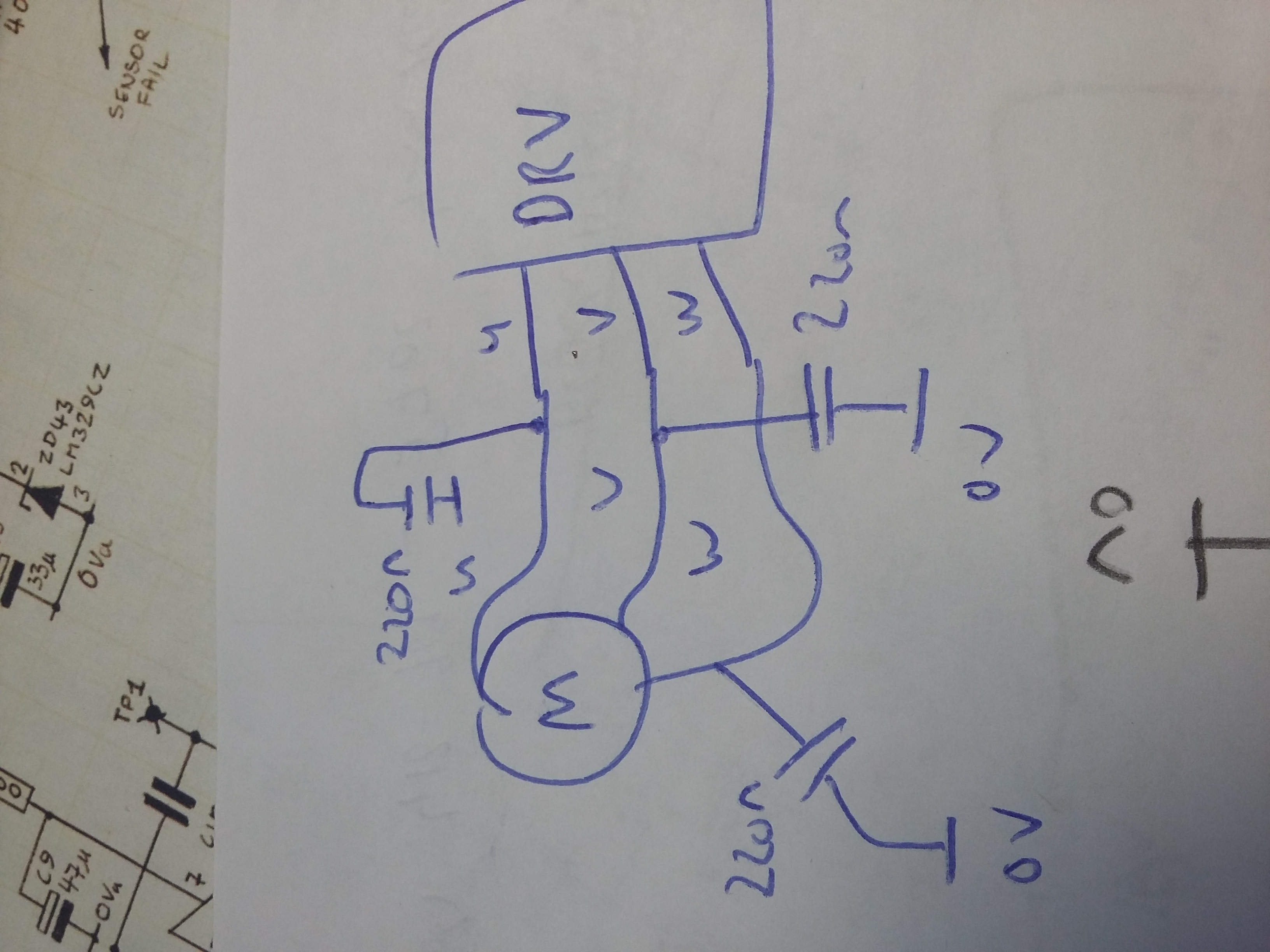

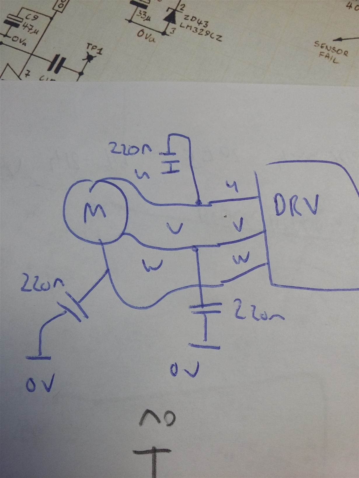

    P.S I tried putting 3* 330n nf capacitors from u v w to gnd to smooth bemf readings in closed loop mode. It sparked and shut the motor down
    DRV10983 does not like  Like Caps across U.V.W to gnd  see picture it nearly blew up lucky after power cycle it recovered
    How can i smooth the bemf reading with extranl caps without upsetting the chip
    doing it like this in picture sparks and shuts the chip down .
    Many thanks for your time and help I appreciate it.

    It wont like the capacitors in that configuration the u,v,w signals are high frequency ac signals, this will ac couple the cap to GND lucky it didnt blow the chip,
    This cant be used to smooth the backemf readings in open loop,
    I will try some ferrite calmps  round the three u,v,w cables close to the terminals for uvw on the driver board
  • Hi Matthew,
    I have not found many ways to smooth out the BEMF waveform with discrete components. I do not know if adding a ferrite clamp will decrease the noise on the BEMF waveform and make the speed holding more stable.
