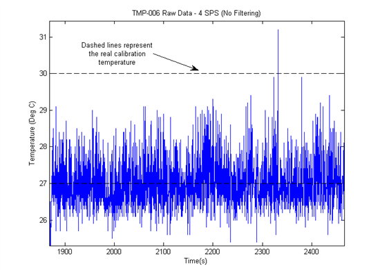

Figure 1: The response curve of the TMP 006 when going through cycle 23-25-27-30-33 degrees C
Figure 2: Zoomed in on noise at 30 degrees C step
These tests were performed under the following conditions:
- 4 SPS ("1 average")
- IR source is a calibrated black body rated for calibration of thermal cameras
- TMP 006 evaluation board powered and connected by USB to laptop
- TMP 006 evaluation board placed approx 1.5 inches from the black body in free room conditions (no coverings, exposed to external room environment)
I am interested in figuring out if there is some way that I can reduce this noise *without* filtering (analog or DSP). My questions are as follows:

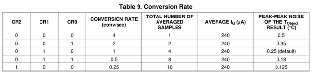

    1) On the evaluation kit, how is the filtering done? I assume that the TMP 006 simply takes multiple readings, and the software then does an average.
    Actually, the averaging is performed inside the TMP006. The software simply calculates the object temperature result based on the data in the TMP006 sensor voltage and ambient temperature registers. Selecting a slower conversion rate that takes more samples can potentially cut your noise in half. See the table extracted from the TMP006 data sheet below.

    3) I understand from earlier posts that better readings can be obtained by shielding the sensor from external drafts (air currents) with say a plastic bag. Will this affect the sensor's performance in any way, or will it simply improve it by reducing noise?
    The TMP006 is indeed sensitive to air flow across the sensor and in the general area of the PCB on which it is mounted, since air flow causes local temperature transients and can also cause a temperature gradient to develop between the TMP006 die and the PCB which results in increased sensor offset voltages and therefore object temperature errors.
    We are currently performing a series of tests with various poly-IR and metallic covers and lenses in order to find the best solution to protect the device, but in the meantime any sort of enclosure you can use to shield the EVM from air currents (while still retaining line of sight between the TMP006 and the black body) should help reduce your noise.
