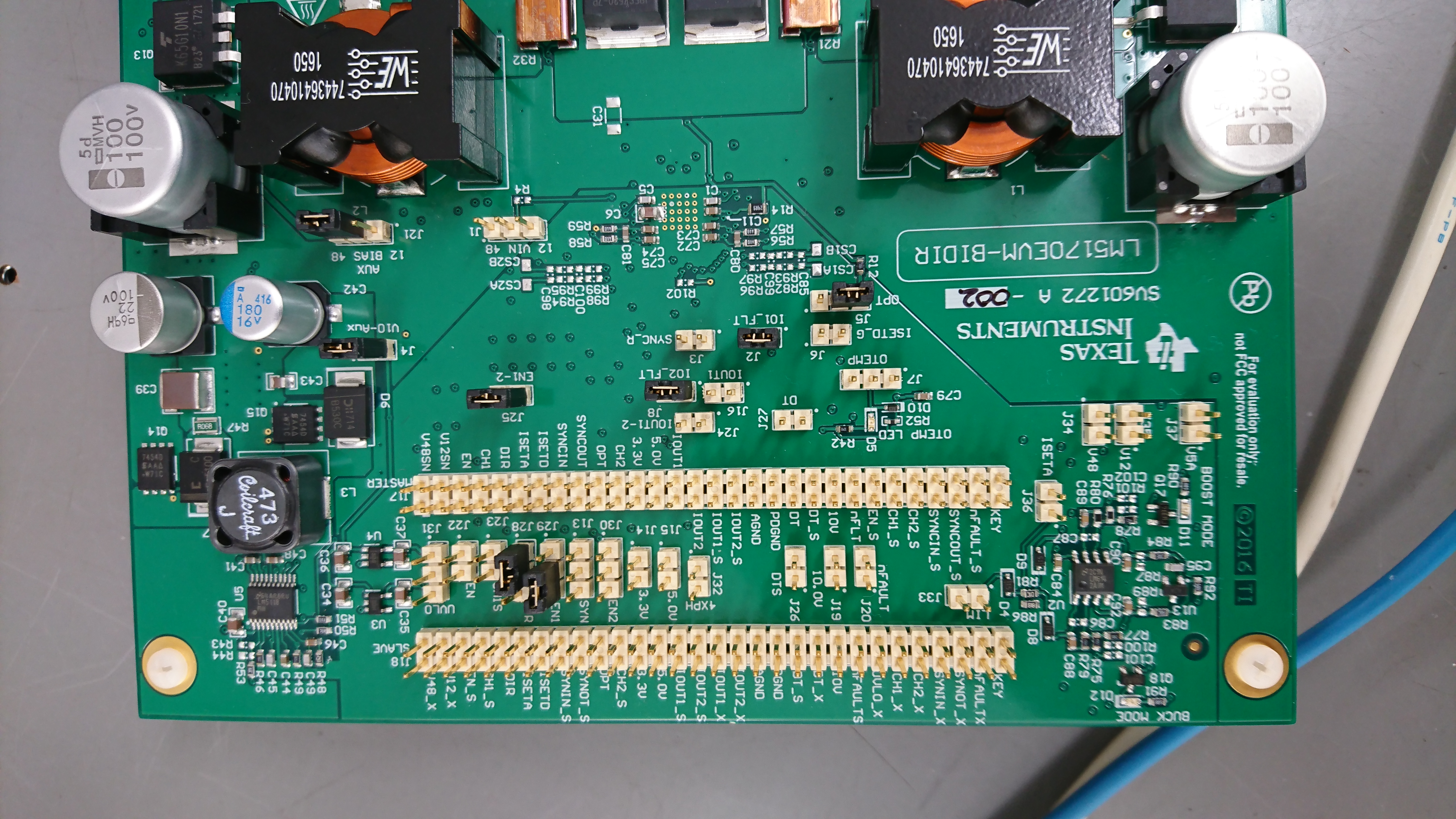

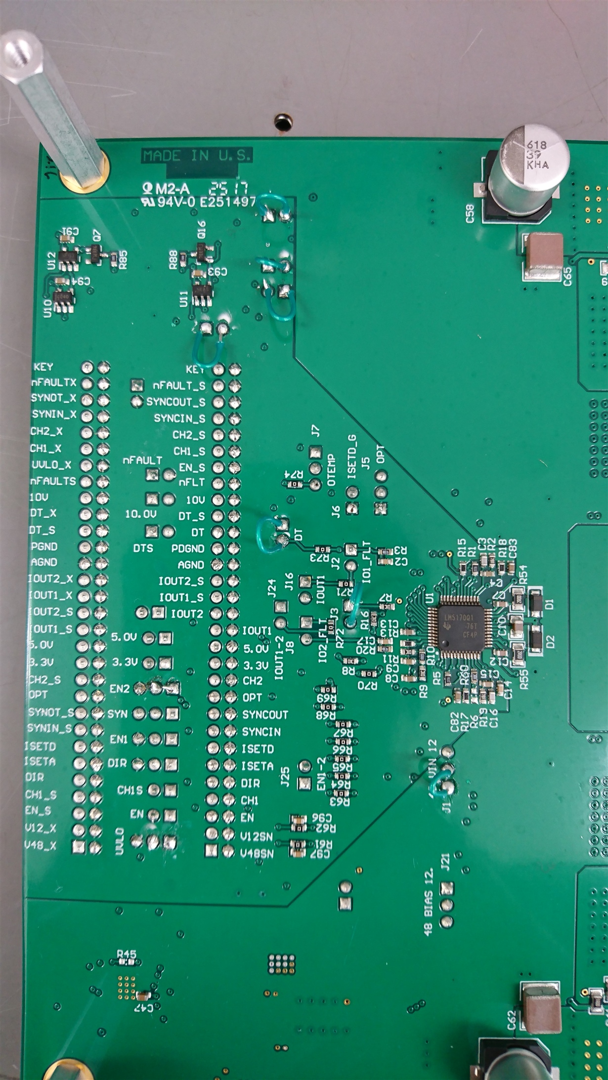

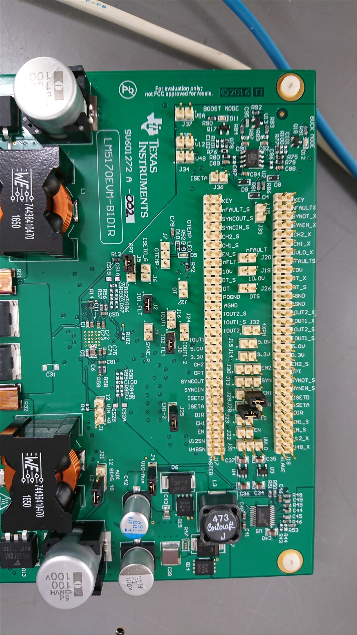

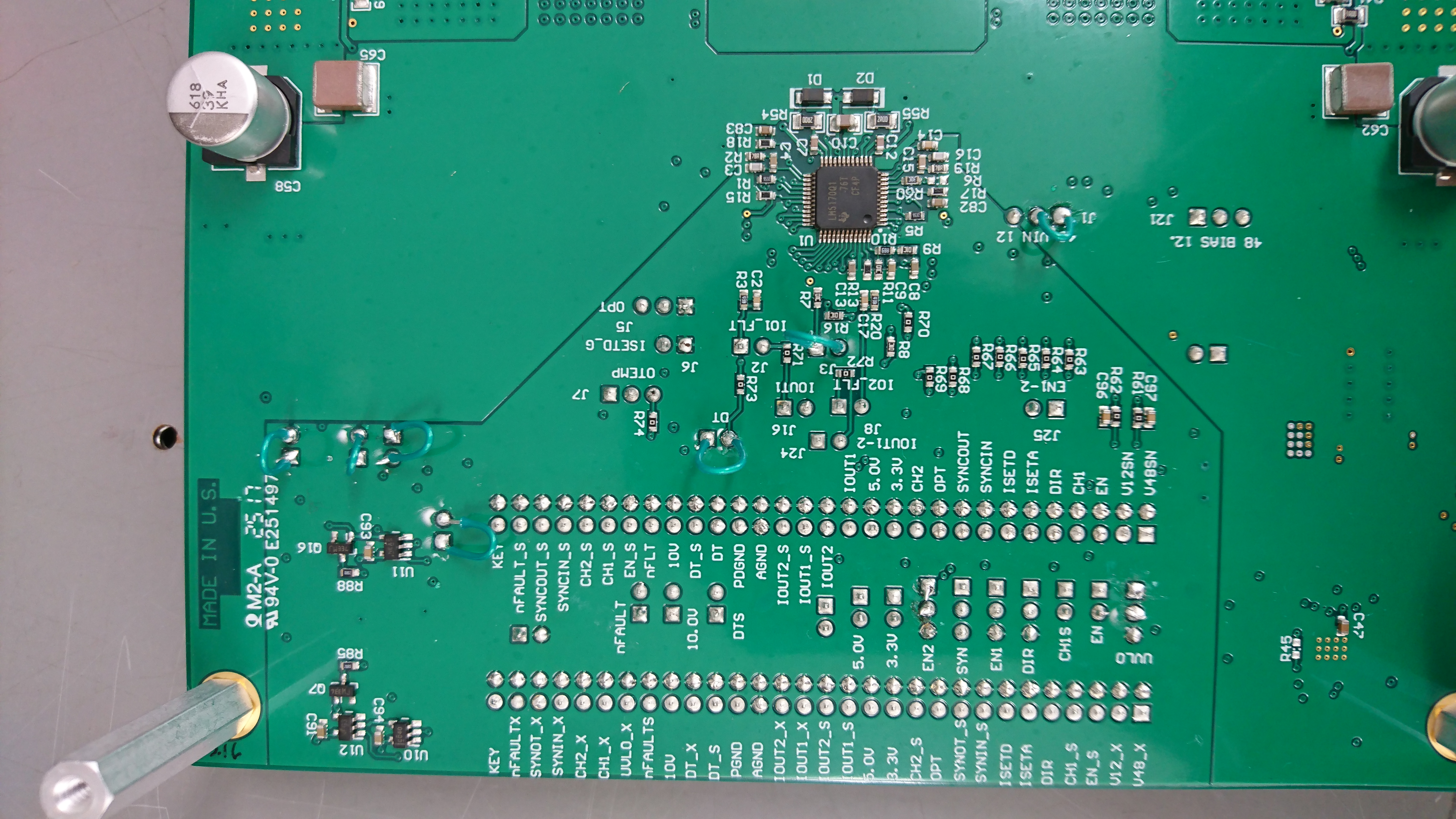

  • Please take a photo picture of your circuit and I would like to see if all jumpers are correctly placed.
  • Dear Youhao,
    Please see atacched.
    I do not have a jumper connector, so I connect with a lead wire.
    Side-A
    Side-B
  • I connected the jumper with a circuit diagram, and confirmed it myself.

  • Dear Youhao,
    Thanks your polite explanation.
    Was my jumper setting OK?
    Once again, + 10V, + 5V, + 3.3V will not be output on the connection of the above picture.
    Is it a breakdown of EVM?
  • Dear Youhao,
