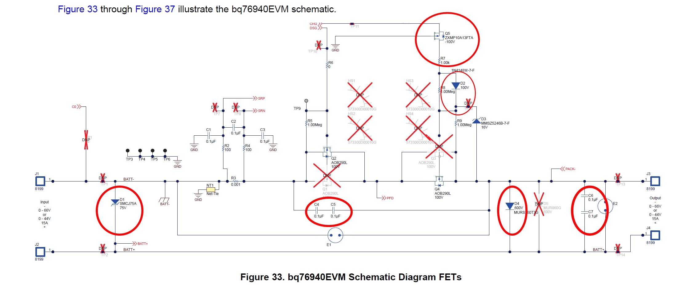

    Please reply on my queries on BQ76940EVM schematic slvu925b.
    1)what is the functionality of C4,C5?why we need to use that?
    2)what is the functionality of C6,C7?why we need to use that?
    3)D1 & D4 used for protection?please explain
    4)what is the use of Q5?can we connect CHG directly to R7 ?bypassing Q5
  • Hi WM5295 ,
    kindly reply on above queries.
    Rajaneesh
  • Hi Rajaneesh,
    1) C4 and C5 provide a low impedance path across the FETs for ESD current. 2 caps are used in series so that if 1 shorts the FETs are not bypassed.
    2) C6 and C7 provide a low impedance path across the PACK terminals for ESD current to avoid it all flowing into the circuitry. Again 2 are used in series to prevent a direct short if one fails.
    3. D1 is a TVS to help clamp inductive response of cells to fast current turn off. D4 is a flyback or freewheel diode to prevent PACK- from rising much above PACK+ when the discharge FET opens.
    4. Q5 allows the gate of the charge FET to fall below VSS so that the charge FET remains off when there is a fault and a charger is connected to a low voltage battery. Without Q5 the charge FET could operate as a source follower with high enough voltage difference and allow continued charge of the battery. See the bq76940 data sheet 7.3.1.3.1 and figure 7-3.
