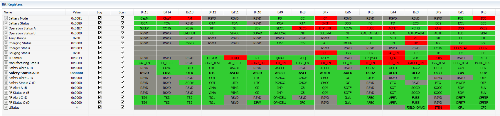

I'm using the BQ40Z60 evaulation board to charge, protect and fuel gauge a 4 cell stack of 1750mAh lithium cells.
I am having trouble with fast charge currents. With the charge current set to around 500mA the device performs as it should. However, when I increase this to around 1000mA the charger oscillates between charging and asserting the fuse (and therefore turning the charge and discharge FETs off).
The strange thing is that no safety alerts are triggered, so it is proving difficult to track the problem.  The image below shows the bit registers just as the charger starts to charge again, but as you can see FUSE is also asserted (it either occurs at the same time or about 0.5 seconds after it starts charging).  This is also strange behaviour since the FUSE_EN is low, which should mean that the fuse is never asserted.

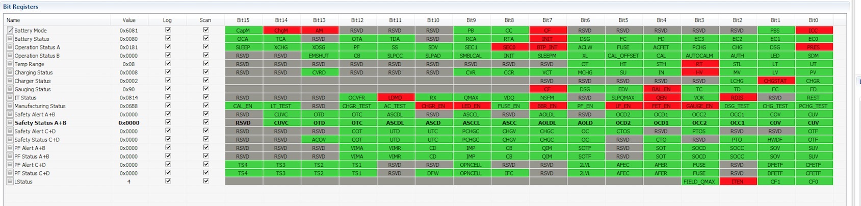

The next image shows the bit registers just before it starts to try and charge again.
Does anyone know what the problem could be? It may be that I've been staring at the green and red blocks too long to notice any problems - any help is much appreciated.

  • Ryan,
    Are you increasing the current limit on the data flash and then the charger cycles on and off? Can your power supply provide enough current to support the charger without hitting current limit?
    Tom

  • Ryan,
    It looks like the cell voltage is tripping the 2nd level protection. Try placing a short across C10 to disable it and see if that helps.
    Tom
  • Hi Tom,
    Nailed it - I completely overlooked the secondary protection since the circuit I've designed doesn't encorporate it. It seems so obvious now as that's why no safety alerts were triggering.

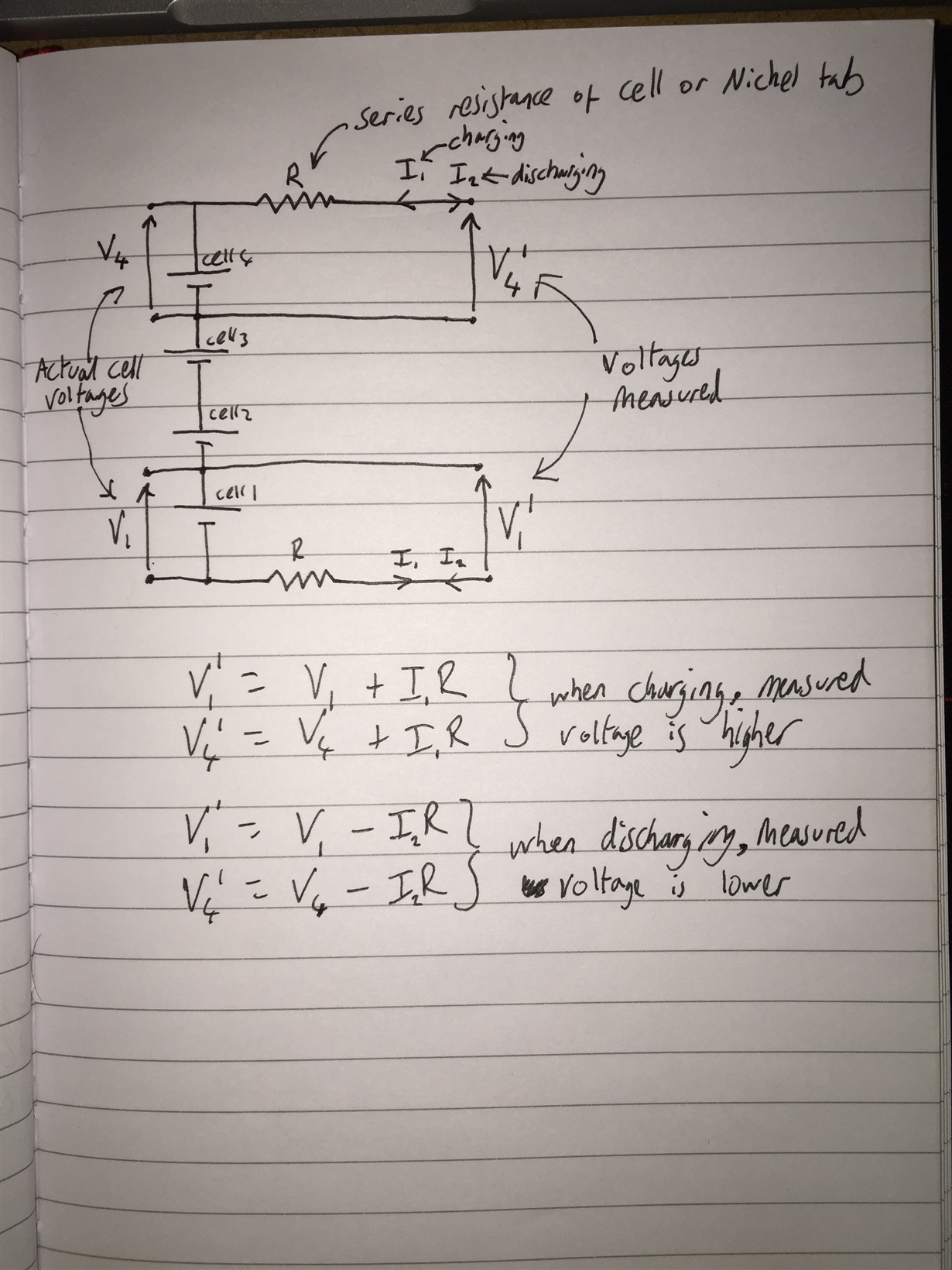

    I have a related question with regards to top and bottom cell voltage i.e. cell 1 and cell 4 in a four cell stack. When charging, it seems that cell 1 and cell 4 are read to be at a higher voltage than cell 2/3. Then when discharging they are measured to be lower than cell 2/3. This can effect the fuse tripping or the overvoltage protection tripping at low charge currents.
    I think this is due to a large series resistance on the cells as in the following diagram:
    I've read that this can be due to the Nickel tabs on the cells, as Nickel has much higher resistivity than copper (I've ommitted the resistance on the other cells, as they don't seem to have an effect on the voltages). Or I was thinking it could be due to the internal series resistance. Anyhow, here is a cell voltage graph when charging at only 500 mA (I'm using 1750mAh cells), the voltage difference is much higher when charging closer to 1C.
    Since I cannot set different cell voltage trip points (this would be a bad solution anyway, since different charging currents would effect it), I'm assuming that I need to do some sort of calibration to account for this resistance - allowing a more accurate estimate of the actual cell voltage from the measured cell voltage that I have access to read.

  • Thanks. These do not bare any relationship to the charge or discharge current on the battery pack, so are not fixing the problem I highlighted above. See below another graph I have produced:
    The voltage being read for Cell 1 is almost 4.6 V during high charge currents. Cell 4 suffers more when discharging. Am I right in saying that this is due to a series resitance? (see above). If not, any help explaining this would be greatly appreciated.

  • Ryan,
    The series resistance will cause the voltage to shift between charging and discharging. You can think of a battery as a capacitor with a series resistance. If the battery is unloaded, then the voltage across the terminals will be close to the "capacitor" resistance, because there is no voltage drop across the series resistor. If you apply a CC/CV type charger, then the voltage at the battery terminals should be the capacitor voltage plus the IR drop across the series resistor. The terminal voltage will increase as the capacitor charges until the terminal voltage reaches the charger voltage. The current will then start dropping as the capacitor continues to charge and the voltage drop across the series resistor drops. The same principle applies to discharging. The larger the discharge current, the larger the voltage drop across the series resistor. This will lower the terminal voltage and reduce the effective capacity of the battery.
    Tom

  • The gauge and charger do not have the option to use a series resistance to adjust the charging voltage. The cells should be fairly well matched and they should track one another as they charge. The gauge also has cell balancing to try to keep them balanced while charging. The bq40z60 is am NVDC charger, so it will step the voltage up as the cells charge.
  • I'm not saying the charge voltage should be adjusted based on the series resistance - in fact I don't have a problem with the full cell stack voltage measure. But the I*R voltage drop at the top and bottom of the cell stack causes an error in the measured voltage of cell 1 and cell 4 (it is only every them two, and I've tested with lots of different battery packs), that error being directly proportional to the load current (charge or discharge). For example, if I increase the current to something high like 1C, the measured voltage on cell 1 increases significantly - sometimes to around 4.6 V.
    The reason I care about this is that I know that the cell isn't actually at 4.6V, I know that what I am reading is {V_cell + I*R}. I want to ensure that the over-voltage protection only trips when an actual over-voltage condition has occured, i.e {V_cell} is higher than the firmware setting. Otherwise, if I set the over-voltage protection to trigger at, say, 4.3V, the charging will be fine until the capacity gets over around 50% and then the firmware will cycle between a charge state and a COV safety alert state on cell 1 - giving me lots of charge bursts depending on the delay setting.
    To summarise, my over-arching question is: How do I charge at high currents - which are still below the recommended maximums - without triggering an over-voltage condition on cell 1?

  • Maybe wires from cells to PCB have high resistans. Can you mesure its?
